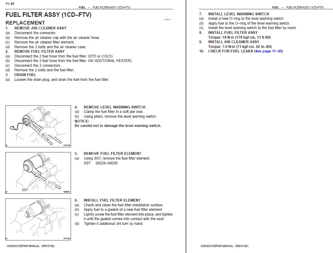

hi all ,can anyone talk me thru changing the diesel filter on a 2006 avensis d4d? or is there a post on here with pictures? i have tried looking for it on here and i did find one post but it was'nt that clear to be honest. or maybe i'm just a complete cabbage! thank you for any advice. about the filter that is not me being a cabbage.
Hi mate here is the method from the Toyota service manual post-74463-1254739403_thumb.jpg :thumbsup:
Regards .... Pete.

Hi there, i don't want you to take this in the wrong way but in my last post i went to the trouble of including an attachment from the Toyota service manual which tells and shows you exactly how it's done!
Here it is again ...post-74463-1255513078_thumb.jpg :thumbsup:
Pete.
Pete.

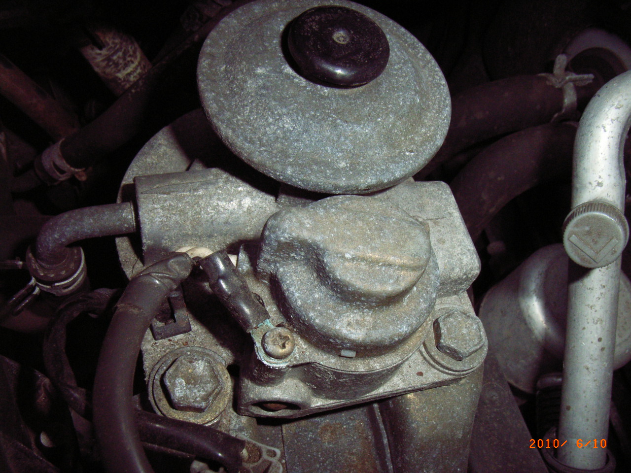

Hi folks,
Just joined, and picked up the very helpful info posted in this topic.
Hopefully you won't a couple more questions! :)
My car's a '54 Avensis Estate 2.0 D4D (is this any different to the 2006 that wheelbrace has?).
1. I can't see where the air escape bolt/screw Igor mentions is.
I can only see what I presume are two mounting bolt heads.
I've attached a photo - could someone point me in the right direction please?
2. The Tech Doc extract t-spiritpete posted describes disconnecting the fuel hoses and removing the whole filter casing.
Are the hoses likely to be loaded with fuel, or will it all drain back to the tank/from the filter draincock before they're taken off?
Many thanks in advance,
Dave
