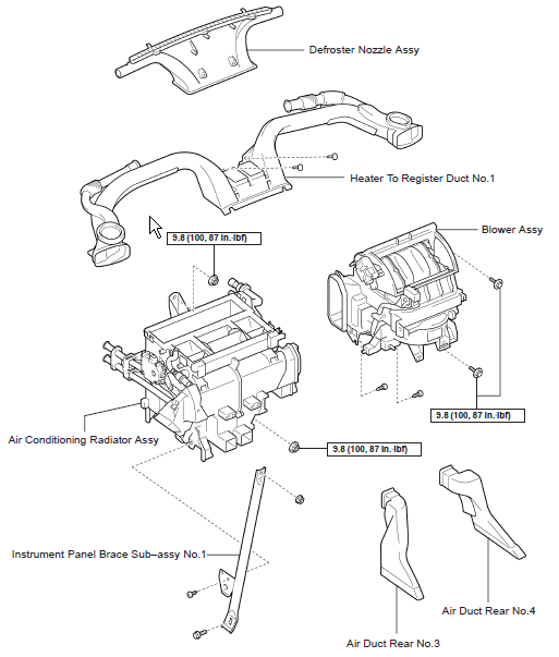

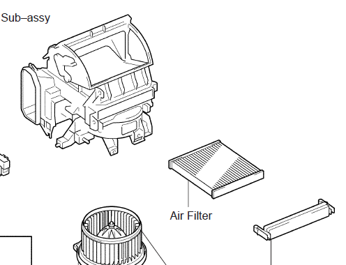

The pollen filter is inside the fan box, not behind it, in a slot just above the fan.
Here's an other picture of the entire heater/fan system.
(You'll have to mirror it, because it's the LHD version.)

sorry to be a pest but any chance of sending the full sub assy picture
Yep, looks like this.
:thumbsup: Thanks will look into this again tomorrow now as that u have send a pic to help much appreciated..ta
here you go its a rav heater box but its the same..
hi ..
this is a gud picture to describe what it looks like but looking at the picture this is not what mine looks like as the colour is black and theres is nothing like this at the front ...mmmmm :huh::blink:
