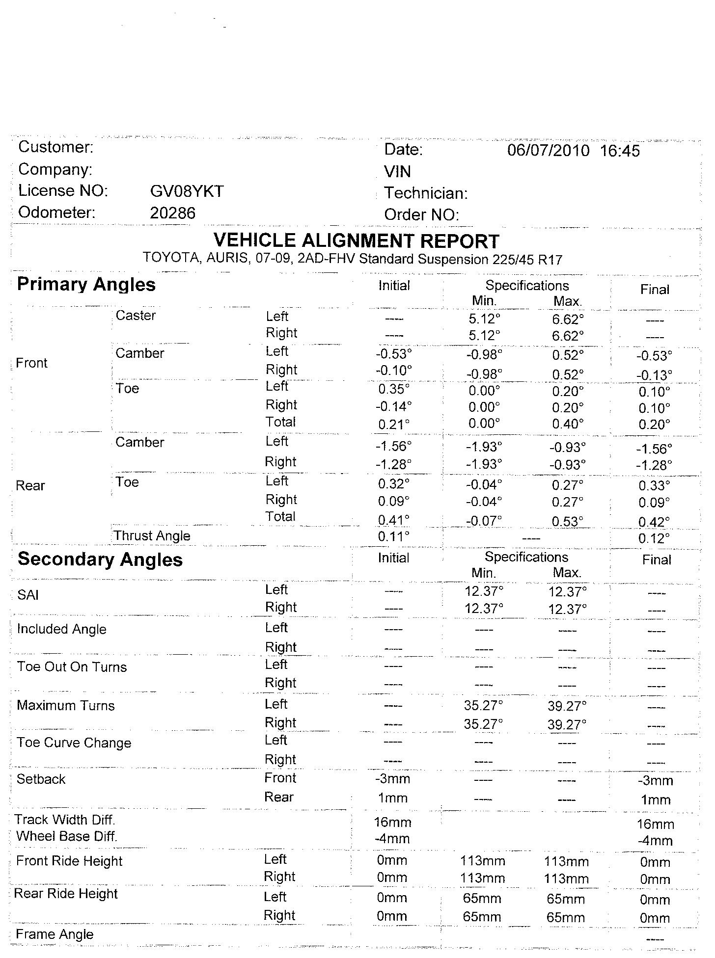

My front tyres have both worn badly on the outside edge i believe the last place i had the alignment done may of
set it up using the standard suspension defaults instead of the correct ones for the lowered sr180.
Basically i got the car and done about 7k then got nail in the passenger side front so had to replace it.
I got to 20k and the driver side front was bald on the outer edge so took it for a new tyre and had the alignment
done since then i have a slight drift to the left, now i can see the passenger side tyre is going on the outside as well.
I have attached the alignment report, can anyone check out for me and advise as i am going to have to get the tyre replaced soon. To be honest i think this has been wrong since i have had the car.
Thanks
Andy
is it lowered from standard or have u lowered it, the garage will use the settings listed on there computer for the model of your car, unless they used the settings for a different model in which case will be different and will ruin ya tyres, i will have a look at work and find the settings for you and u can take these to the garage to see if they have used the right settinigs

The car is totally standard and is lowered from factory, i reckon the setting they used are for the t180.

hi Andy SR180, sorry ive took so long in finding the settings, according to autodata, the program we use at work the settings are the same for all 2.2d models.
they are set at +1mm, ive also spoken to toyota who also said they are the same.
now for the baffling part, there is something called bump steer on a car, if the car is not weighted correctly this will effect the alignment of the vehicle.
bump steer is where the front end will drop and around 60mph which is why u weight the car down to mimic the speed,
i lowered mine 30mm so had to do mine, ive tracked mine without weighting the car BUT set the alignment to +2mm and not had any problems at all
