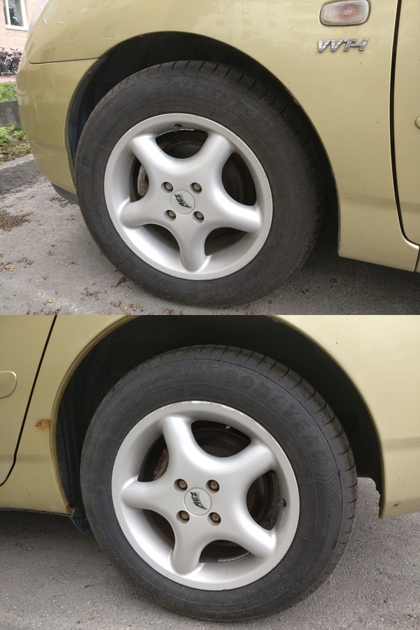

Really late thread bump, I hope such is accepted on this forum, i.e. not considered thread necromancy, which is not my intent.
I drive a 2002 Corolla Verso, and currently on 185/65-15 wheels. I know this isn't even listed as an OEM configuration, but it's well within specs.
However, 195/60-15 is one OEM specified tire size for my vehicle (4x100 bolt pattern),
whereas the newer Corolla Verso (5x112 bolt pattern) has 195/65-15 as one official tire configuration option.
Now, I have a great deal on such wheel, and would be happy to put it on my rims, but I'd like to get approval by someone who has had it before I rush in.
So, anyone with a 4x100 bolt pattern Corolla Verso that has put 195/65R15 wheels on, and could verify that I will still have wheel arch clearance?
I live in a country where neither "DMV" or insurance companies are so strict about flying away from OEM specs.
I would, however, really hate it if I run into a situation where front wheels start rubbing in the wheel arch when I turn the wheel fully.
Please, fellow Corolla Verso owners, share your experience! :)

Heh, I had no luck on getting response but I took a chance and bought myself four pieces of Goodyear EfficientGrip Performance 195/65 R15 91V. This was early this summer and I've experienced no issues with rubbing or such whatsoever. Just thought I'd mention it, if anyone stumbles on this thread from Google search. Also, there is still plenty of space in the wheel-well, as you can see! :)
