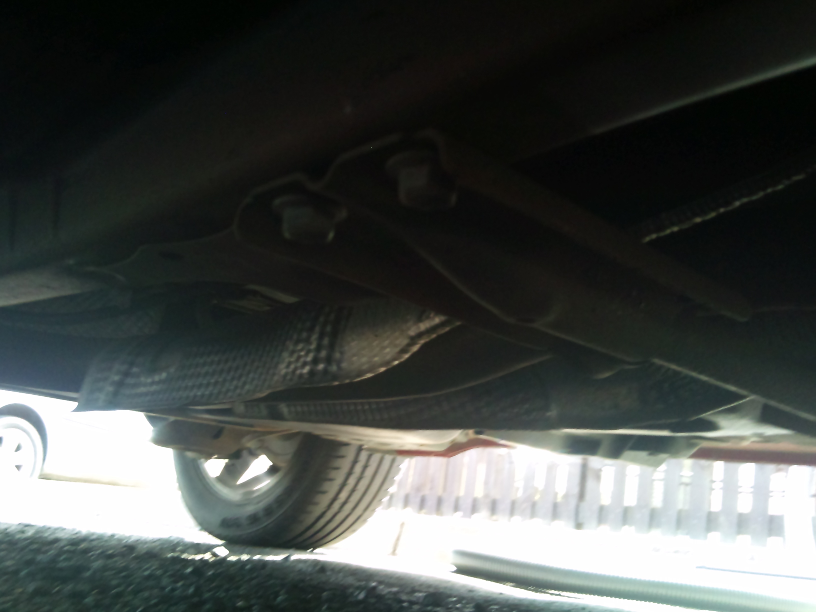

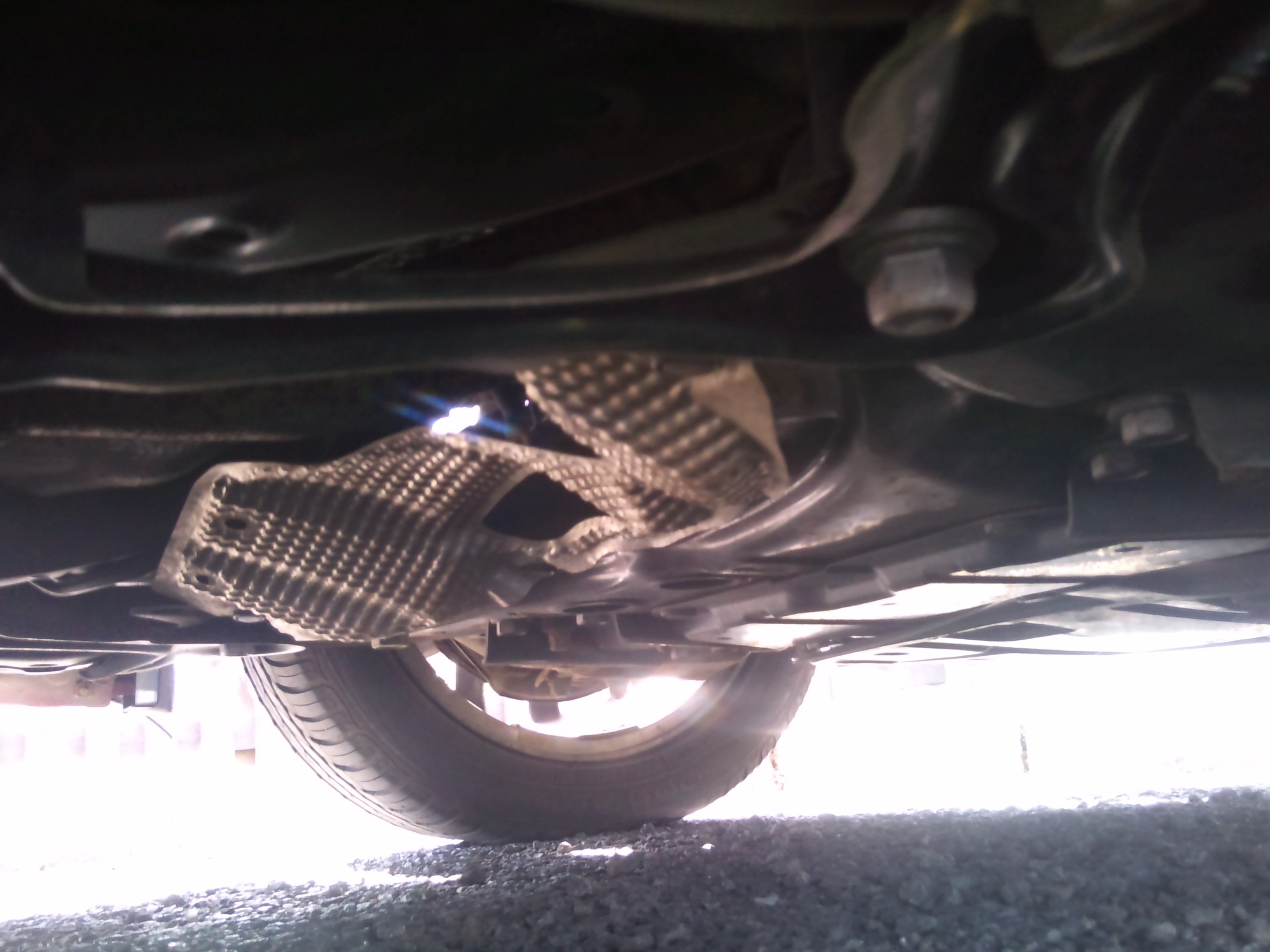

Hi guys,
My Auris has a piece of metal on the underside that doesn't appear attached properly that is causing rattling through vibration when the engine is running. I'm not entirely sure what the piece, whether a shield for the exhaust or something else. This is in picture 1 if anyone can tell me and if it is something I need to worry about it. Picture 2 is something of the same material beneath the engine, I'm guessing this is possibly the sump guard, not sure if this is rattling through.
I will add the car is going in to Toyota this week anyway, but thoughts are appreciated. I've got to take it in because of the steering causing clicking noises which has been mentioned on here before. So hopefully they will fix this in warranty.
Cheers. :thumbsup:
Andrew
post-15677-0-44757000-1303046966_thumb.j
post-15677-0-80292500-1303047024_thumb.j
Looks like a heat shield to protect underside from exhaust heat, def doesnt look attached properly....
Good idea to book it in, hopefully between now and then it wont come off when you're driving!
