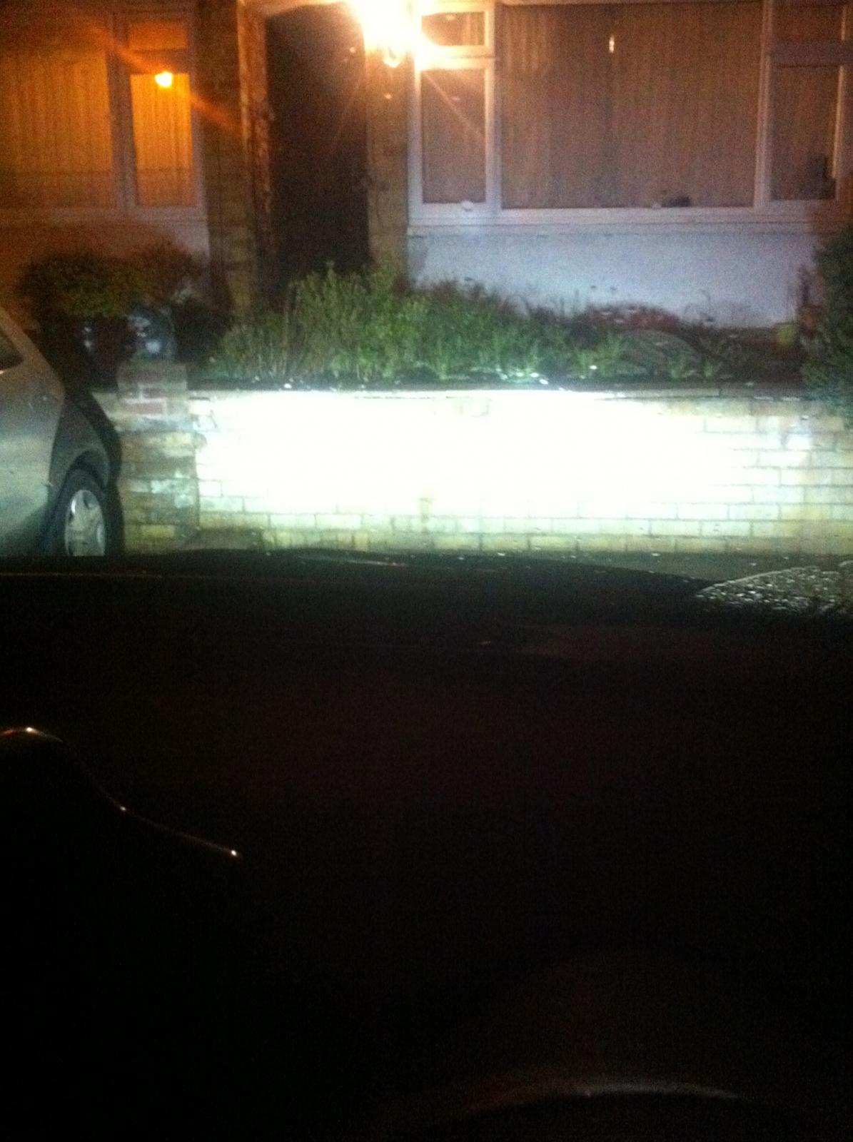

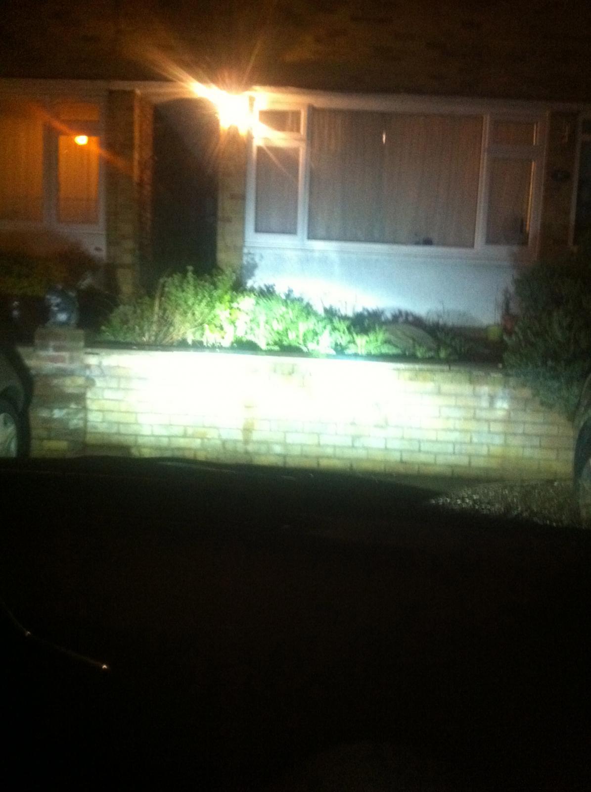

Hi david have you got a photo of your car with the lights on so i can see what there like
Well unfortunately i only have my iPhone to take the photo's and it doesn't like bright light so i have taken 2. One is dipped and the other main against a wall and a house wall. Not sure if its any help really.I can tell you the change was dramatic
David
post-109788-0-94937100-1335217435_thumb.
post-109788-0-68831500-1335217470_thumb.
