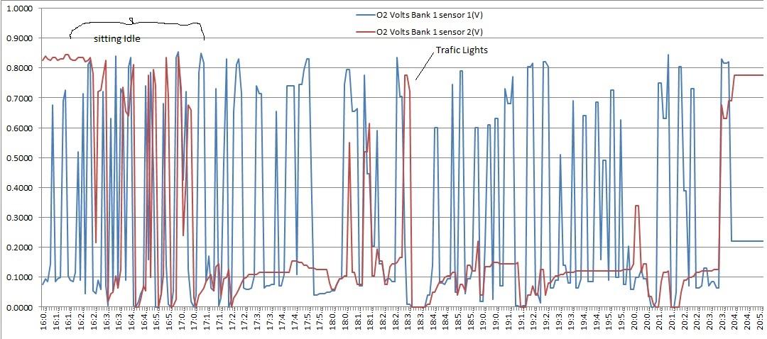

For a month or so I've been driving with the engine light on, it happened once before and disappeared by itself. I got one those bluetooth obd2 scanner and reset the light. Now I see the 'Pending 0420' code.
Please can some one tell me if the o2 sensor are ok from this graph. I hope I plotted it correctly, used Torque Pro, still getting used to it.
It appears the when at a stop or idle sensor 2 is oscillating instead of stead reading, seem to OK when o the go.
Is it the sensors or am I going to have to fork out fore a catalytic converter?

Looking at your graph, Bank 1 sensor 1 should switch like that, as it is reading the emissions, and adjusting fueling to suit.
Bank 1 Sensor 2 on the other hand should be a lot more uniform.
I went through this with a corolla, and changed sensors to no avail.
An emissions test should indicate.
The sensors are pretty robust. Is your car burning oil?
If its not a sensor fault, it s most likely a cat fault.
Generally, but not always once the post cat sensor reading (B1S2) is similar to the precat (B1S1), it would be indicitive of Cat failure.
A Precat sensor fault would create a poor running engine, and perhaps down on power

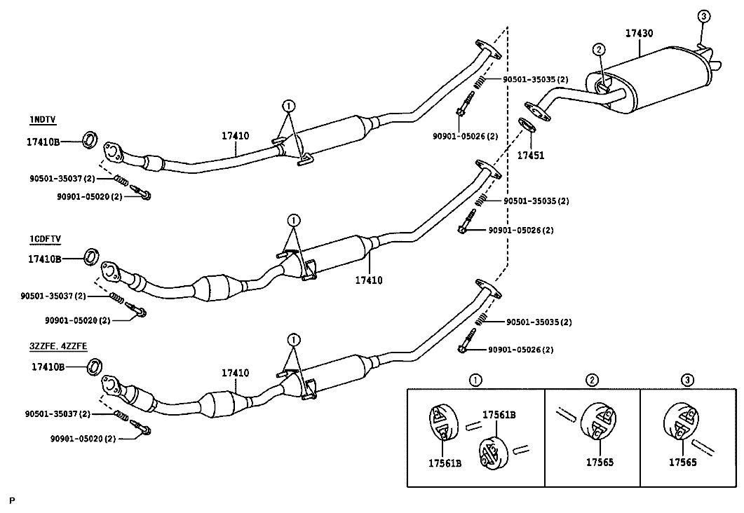

If it's an original exhaust, the exhaust should run from the flange between the engine and cat right back to the rear silencer, with no joint. And if you are doing any exhaust repair, do not use any exhaust paste pre cat. Also beware they are quite heavy.
The rear box on my e11 is original and still shiney.
Mine looks very similar to bottom one on the picture, 3zz-fe.
