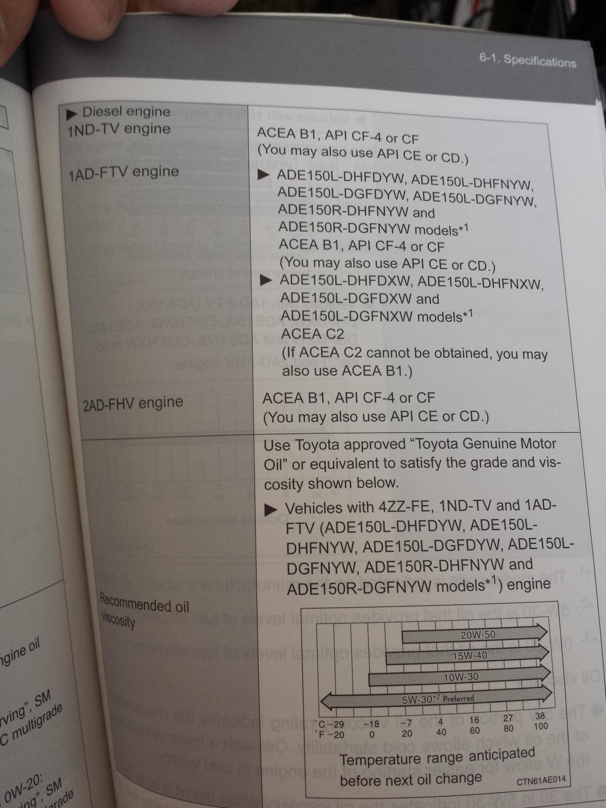

I'm rather confused about what engine oil I need for my 2007 Auris 2.2 180 - 2AD FHV...
All 5w-30
Most websites are recommending C2 or C3 oils which I can understand due to the DCAT but my handbook is stating B1?
Can anyone shed any light?
Thanks
post-102799-0-17756400-1424526897_thumb.
The oil spec in the owners manual is the minimum requirement was current at the time of printing and when the car was new - oils do get improved and oil specs updated over time.
