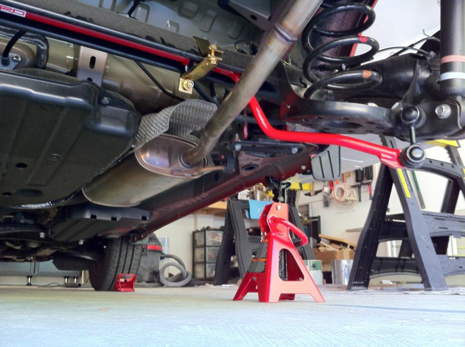

Does anyone here have the TRD sway bar kit fitted to their car?
I have been looking at them recently and wondering about getting one shipped to the UK.
For anyone that doesn't know, they are more of an anti sway bay and reduce the body roll in corners by linking both sides of the suspension together with a fairly rigid bar. The suspension is still free to move up and down so the ride quality won't change but the bar resists the movement if one side of the suspension goes up and the other side goes down which is what happens when you go into a corner and the body leans over.
The attached picture shows the bar fitted in bright red.
It looks a pretty good kit, bolt on simplicity and apparently it comes with new, stiffer bushes for the already fitted front sway bar.
Just interested to hear any thoughts on them. Did it make a difference, easy to fit, where you found it, price etc...

I'm sure someone has posted in the past that they hade one, but found the drop links tended to get grounded at times. I'm sure there is a different type available that has a 'C' shape end that bolts to the lower coil spring housing so not affevting ground clearance.

I have the TRD rear sway bar on my iQ. Simple installation. The kit includes new front sway bar bushings as well.
Due to my iQ having air suspension I don't reap the rewards that a more "racing" type suspension with coilover or lowered springs would achieve but I do like the added stability of the rear sway bar.
Cheers Taz
It does look nice and neat under there. The links do hang quite low but being so close to the wheels I don't think it will cause clearance problems really. Certainly not speed bump problems anyway.
