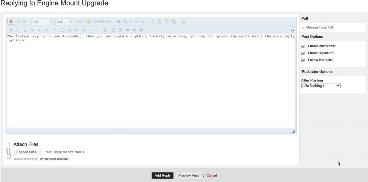

The fastest way is to use a program called Greenshot, then you can capture anything locally on screen, you can the upload the media using the more reply options:
Then add to your post ... Simples
Click to enlarge
Thanks for that. I have now downloaded Greenshot, cheers.
