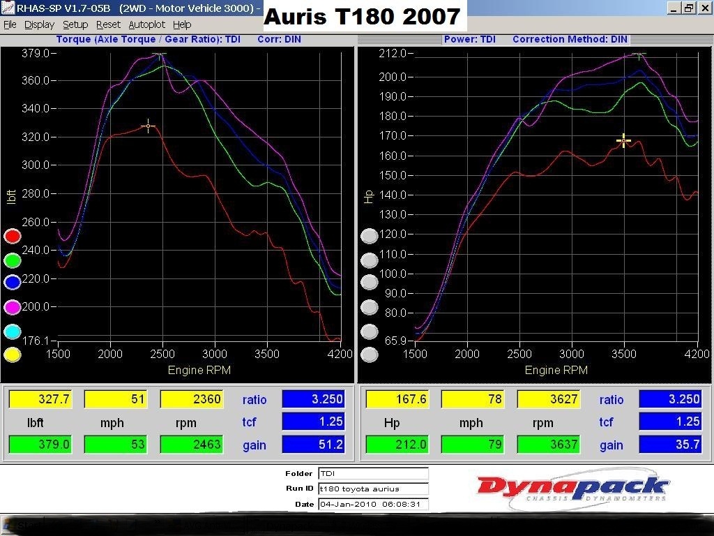

Take a look at our dyno graph of an Auris T180
People confuse power (BHP) with torque. The max torque on the Auris we used was 2463 RPM, revving it to 3.5K and more (as some have said on here) will be no good at all. Take a look at the right hand side of the graph, power, the max power on our Dyno model was at 3637 RPM, power drops right off past this RPM, and would never pull any more past these revs
Our tuning box is mapped specifically to the engine you have, unlike other chip kits that have a generic file inside where you have to faff about with jumper settings in order to get the right feel for the car
