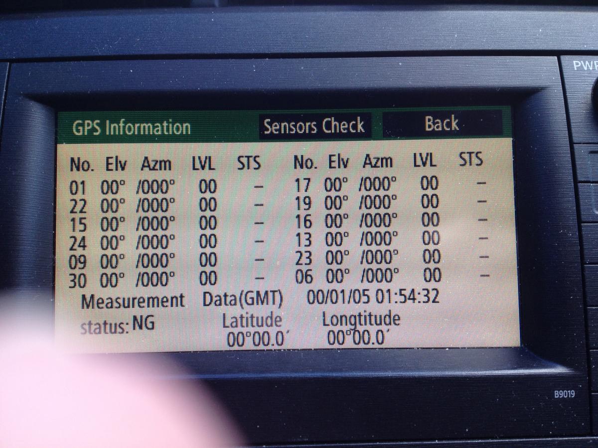

On the subject of the GPS, I went to the setup menu you suggested, and recalibrated my position, but it jumped again.
I went into the hidden menu showing faults, etc and found this (picture attached).
If I'm reading it correctly, I'm not getting a signal. Any ideas where I go from here!

Do you have a standard aerial or is it an aftermarket or shark fin type? The standard is about 8 inches tall with what looks like wire wrapped around it, all covered in plastic.
The fm reception in an early gen3 is poor but is yours poor or really really poor? Wondering if someones been playing about back there. Or has someone had the satnav unit out of the car and stuffed it back in pulling the aerial out in the process.
Hi again!
It's the standard 'wire wrapped' one.
I have to admit the reception is very bad on my street. Even mobile phones drop out constantly.
I took the car a few miles away where I knew the signal was good, but got the same 'no signal' result.
I bought the car second hand from a Toyota dealer last February and it was perfect. It was like that until I left in into the dealer for the recall software upgrade. I can't be sure, but I think problems started some time later (but strangely, not immediately after!).
That's the only time the car has been out of my sight, and I can't imagine the software upgrade involved pulling bits out of the car.
I went to EManualOnline.com and bought the service manual (£9.99)

Am I reading between those lines correctly?
It's a strange issue and one I've not come across in 5 years on the forums. Consider asking on the priuschat forum. Normally this UK forum will suffice but with weird errors there's usually someone on there who has come across it. There are one or two members who know the car inside out in ways nobody should.
Try !Removed! the aerial off and wire brushing the threads, they get a bit oxidised sometimes. The base that the aerial screws into is actually an amplifier, this could be faulty.
I thought that the GPS had its own aerial that lived up under the dash behind the MDF and below the windscreen. Is it possible that it was removed in your service and was not re-connected properly and has now fallen out?
The aerial on top of the gen3 prius is just the FM aerial - nothing to do with GPS.
There will be a separate GPS aerial for that.
The screenshot suggests that the GPS aerial isn't working (or not there).
However, the past couple of days, GPS reception in my area has not been good but it does manage to find a few sats rather than none at all.
