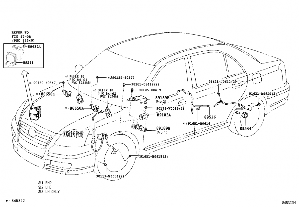

the full part number is 89183-05020
in the picture its 89183a

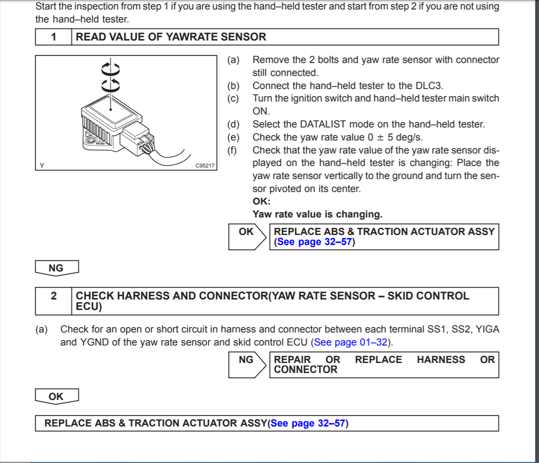

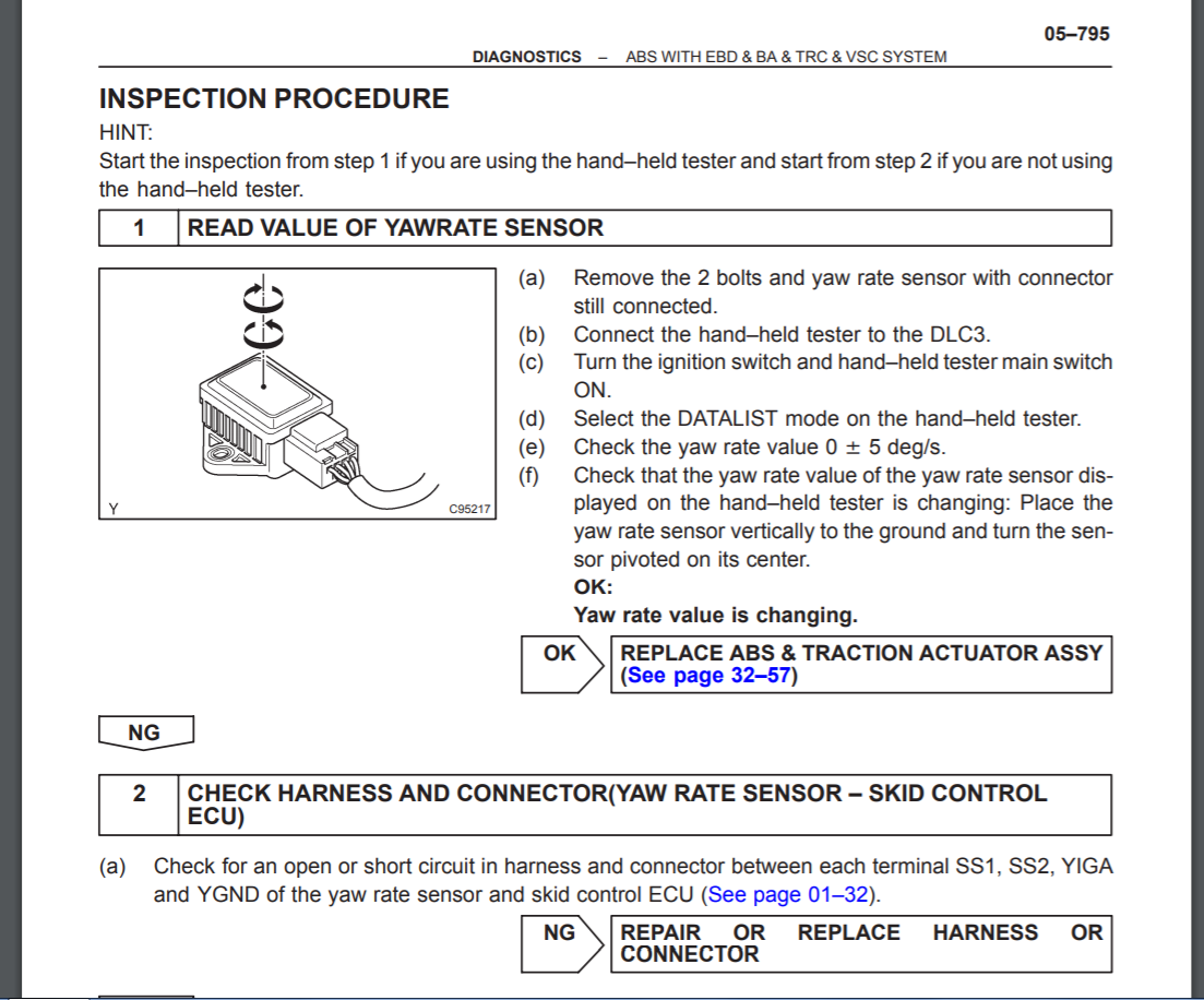

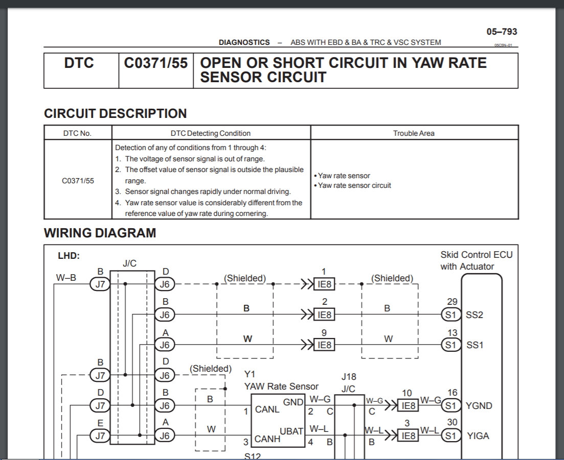

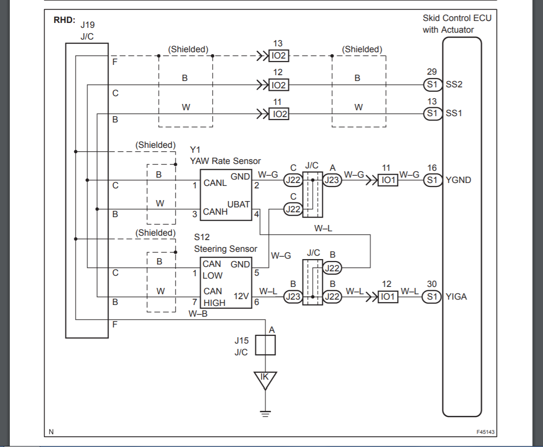

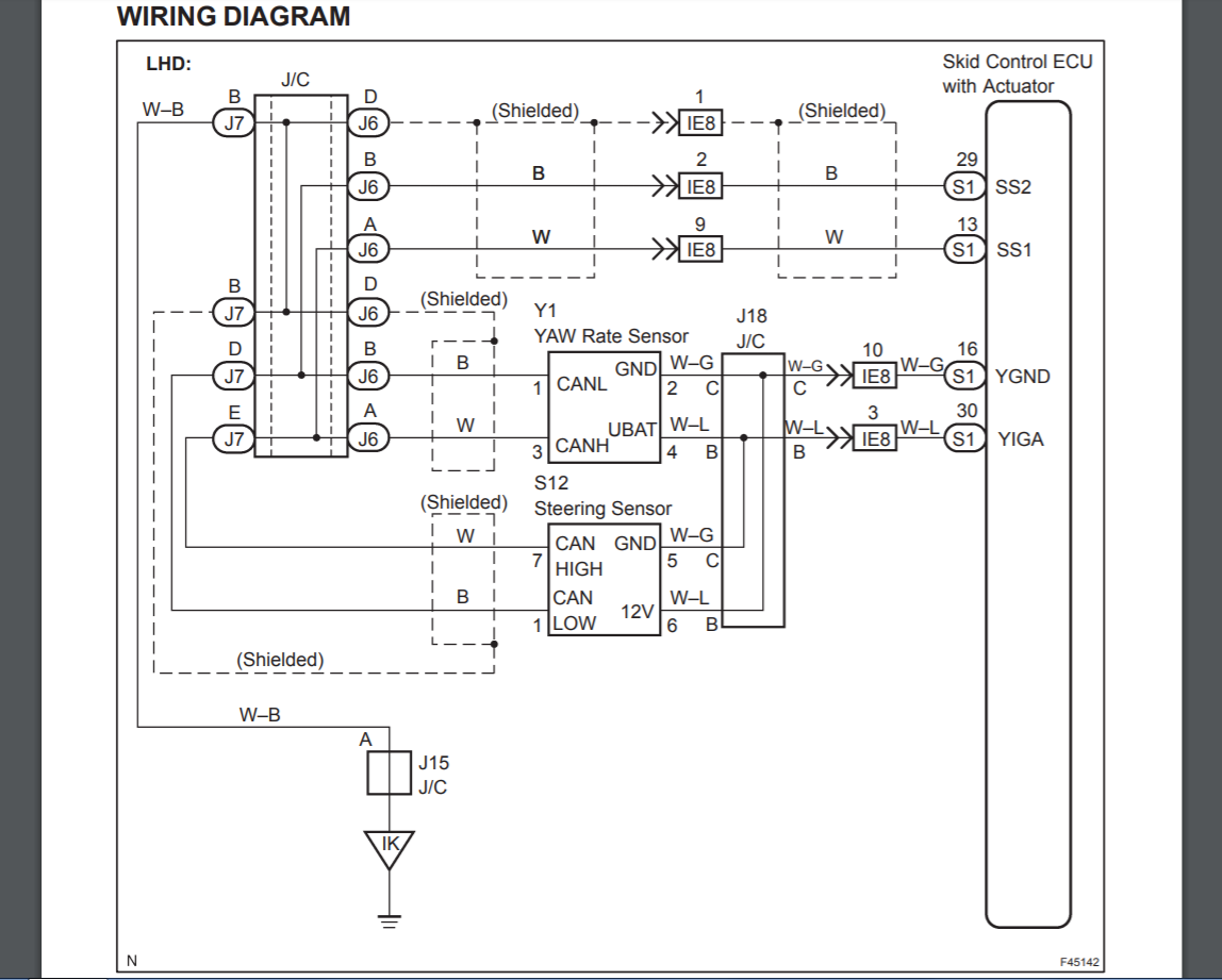

have a look at this testing method.
Pm me your reg I will get you the part no for your sensor if needed
AVENCIS YAW SYSTEM (1).pdf
cant seem to open this, wouldn't mind a read at it if poss??
