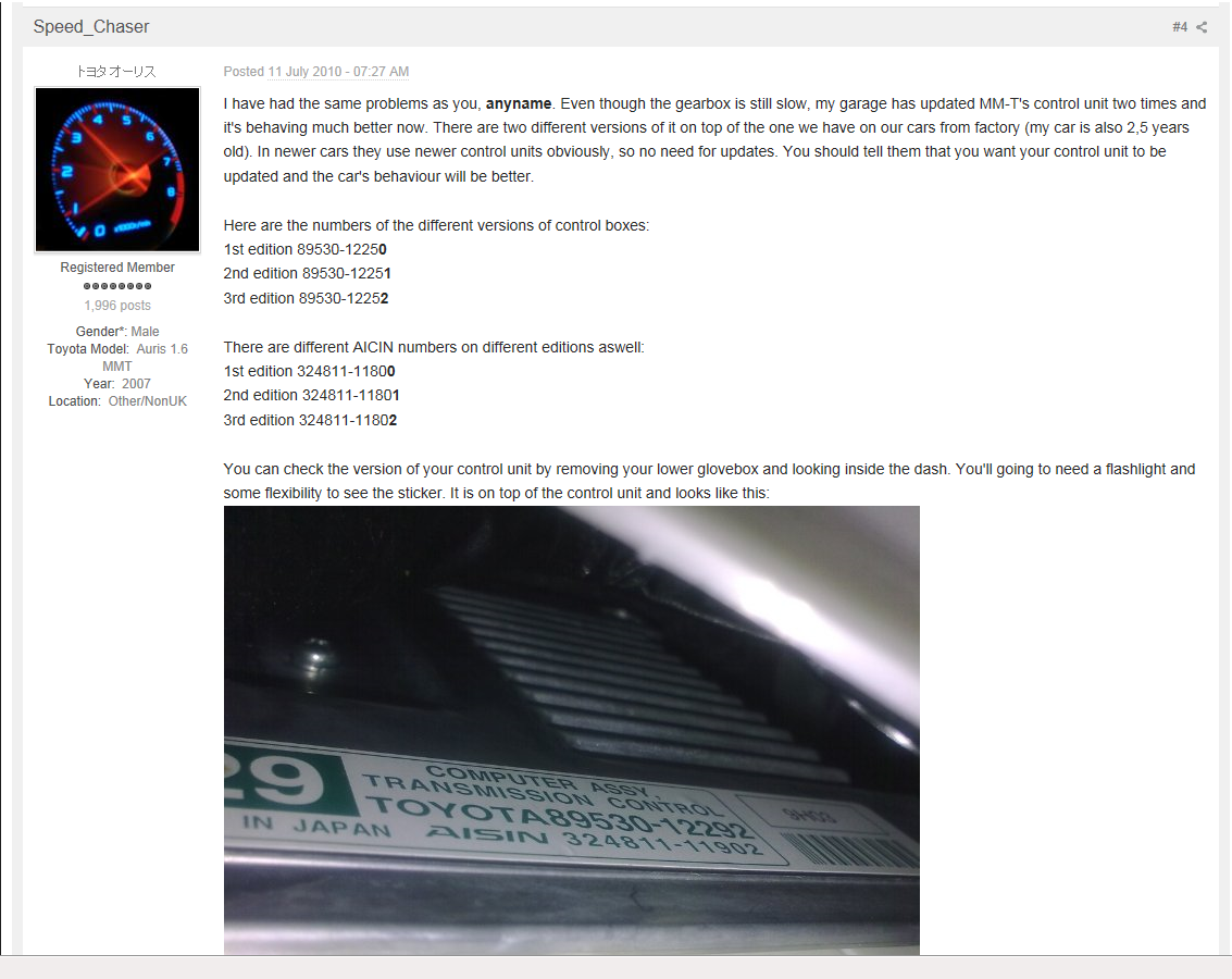

I have been reading the forums about some sort of upgrade ? An ECU? Will that help. It seems quite slow coming off roundabouts and junctions. which seems quite dangerous in rush hour.
