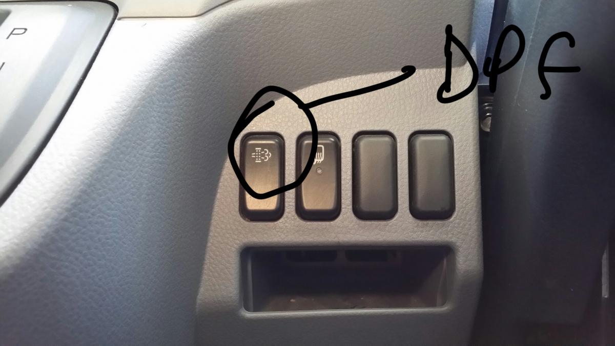

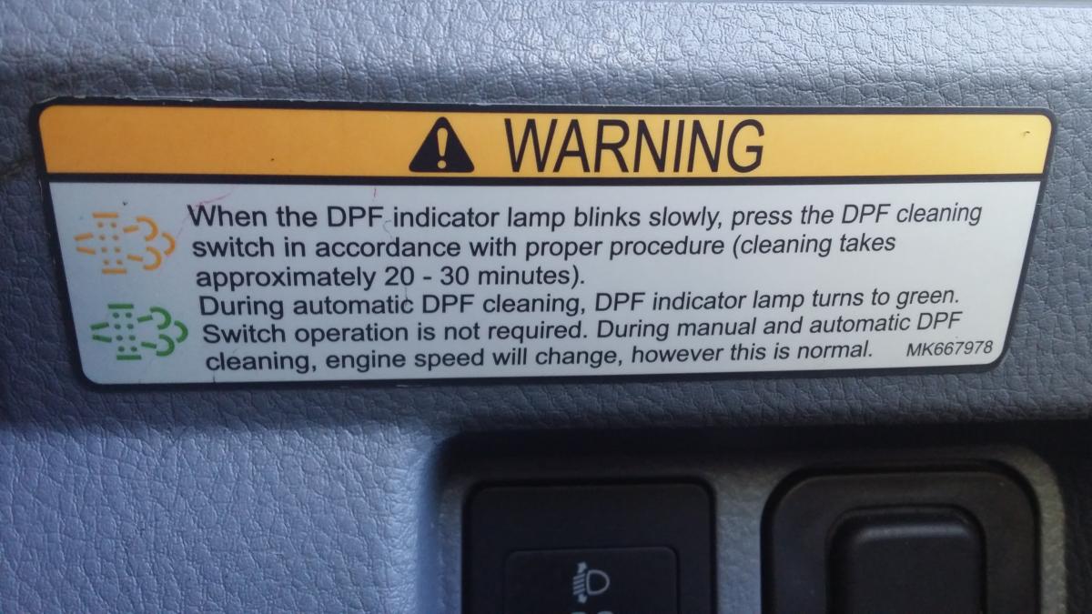

I'm curious how the DPF works on cars. i.e does it light up on the dash during the regen cycle, can you manually regen or does it all happen in the background so the driver is unaware it's even happening.
Added a couple of pics I took earlier on my tacho break of the DPF warning and manual regen switch..... do you have these on a car??

think that it depends on the car whether there is a DPF regen light - I don't think that Toyotas have it but some other brands do.
Similarly afaik Toyotas don't have a manual regen button (but they can be forced to regen via software) but perhaps another brand may.
Cool hust curious really. The job i've got now am driving a Fuso Canter which the photos came off... haven't seen even the green autoregen light come on but my last job it was an Iveco Easyshift 7.5 tonner and it always a real a nightmare. The DPF light would come. on regularly and if it flashed orange or red for a manual regen it also. went into ultra limp home mode, max speee 35mph and it need miles to get up. to. that speed.... not fun at 8pm 120.miles from. home haha. Found out by trial and error never ever switch the ebhine off during auti regen.
