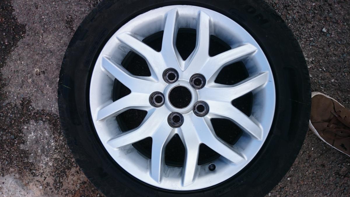

I'm not taking them anywhere, I'm doing it.

I bought solid black today, so will give it a go. See what happens ^^
Need to see the wheels first to be able to tell.

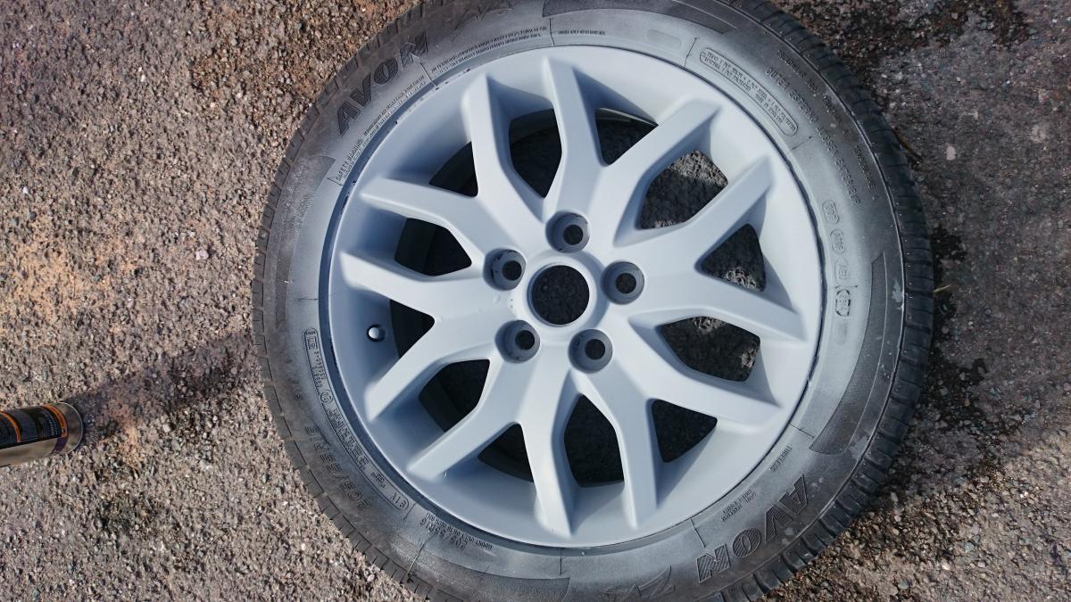

You could have at least masked off the tyre lol
I did at first. But tape doesn't really stick to rubber xD
If memory serves back in my youth when I did this kind of thing I rubbed a soap bar around the tyre,the paint doesn't stick to soap.
Another idea is to get a piece of cardboard,cut a circle in it and that becomes a shield for the tyre.
I'll try this to help tomorrow when I actually paint them. See what happens xD
Or duct tape will stick on to clean(ish) rubber

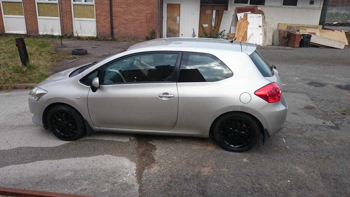

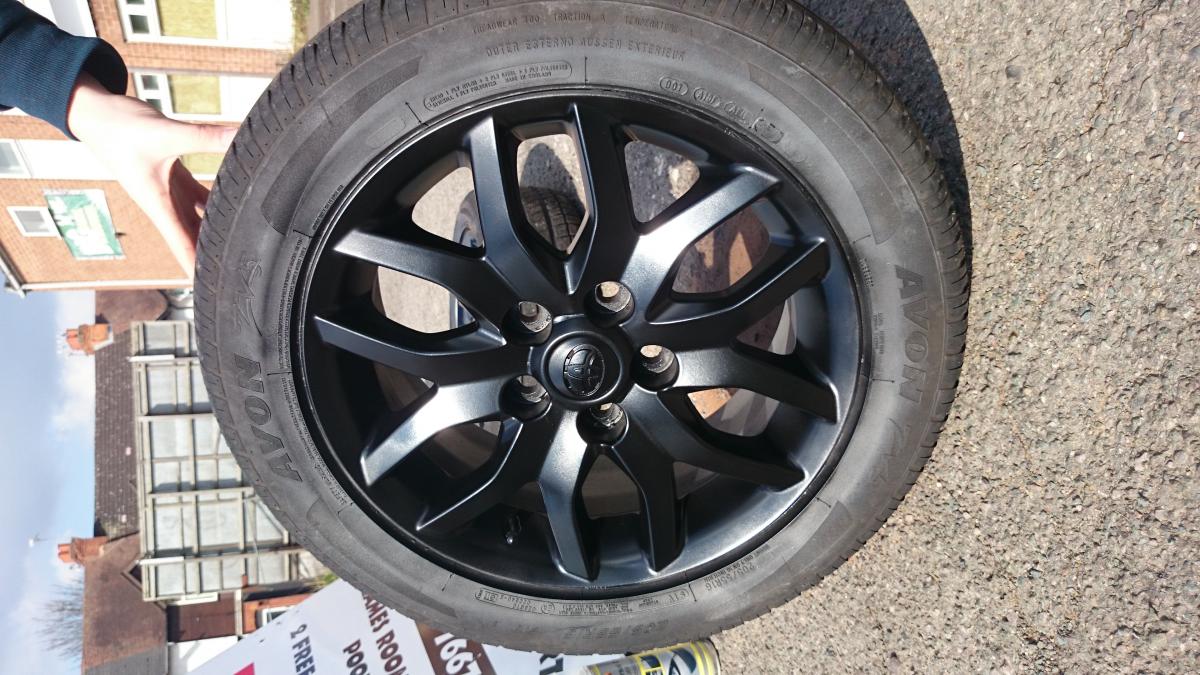

Black done, just lacquer left
post-130876-0-52518500-1427282856_thumb.
Finished, probably should have taken longer, but don't have the time. When I do I'll do more to them like detailing.
post-130876-0-85545400-1427291315_thumb.
Excellent job... Where did you get the paint? .... Just plain Halfords stuff or specialist spray cans...?
It was the alloy wheel paint from Halfords, and I used their bodyshop primer and the heavy duty lacquer it's had 2 coats of the above and looks pretty good now, obviously just try not to drive the car between the primer and paint coat if possible (I did this and it did some funny things, I assume from the heat of the brakes)
