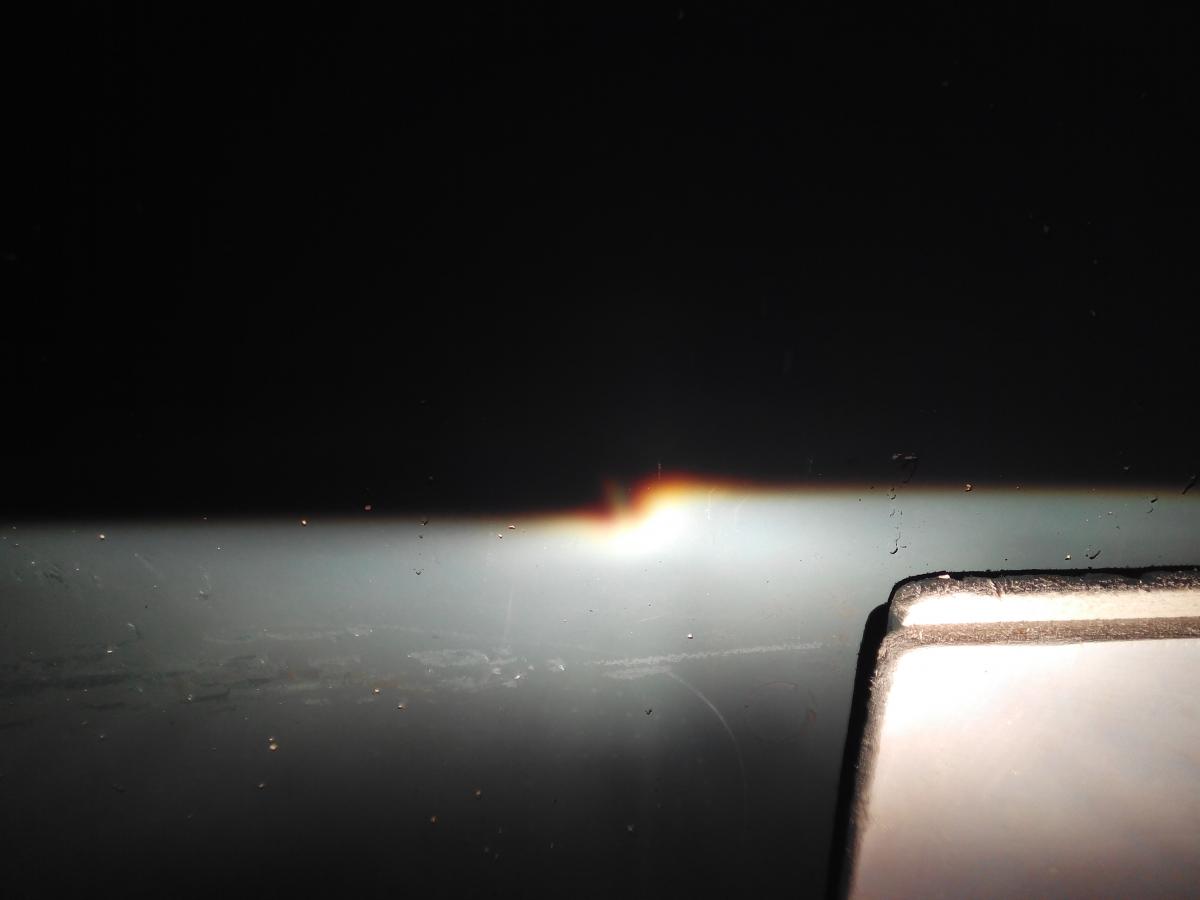

on Spanish Auris Club we found and issue with the front lights of a lot of Auris 2013 and 2014 versions with halogen lamps.
The issue is due the heat of the lamp, that burn the metal part that switch from high lo low beam lights.
To see if your car is affected with this issue turn on your lights near of a wall, you will see some extrange "horns".

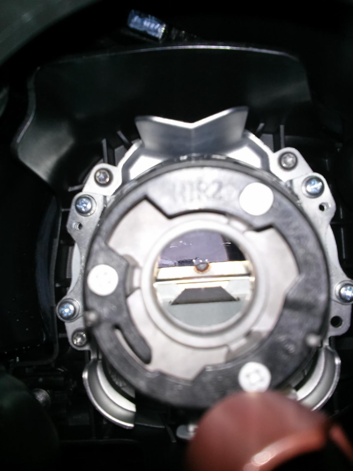

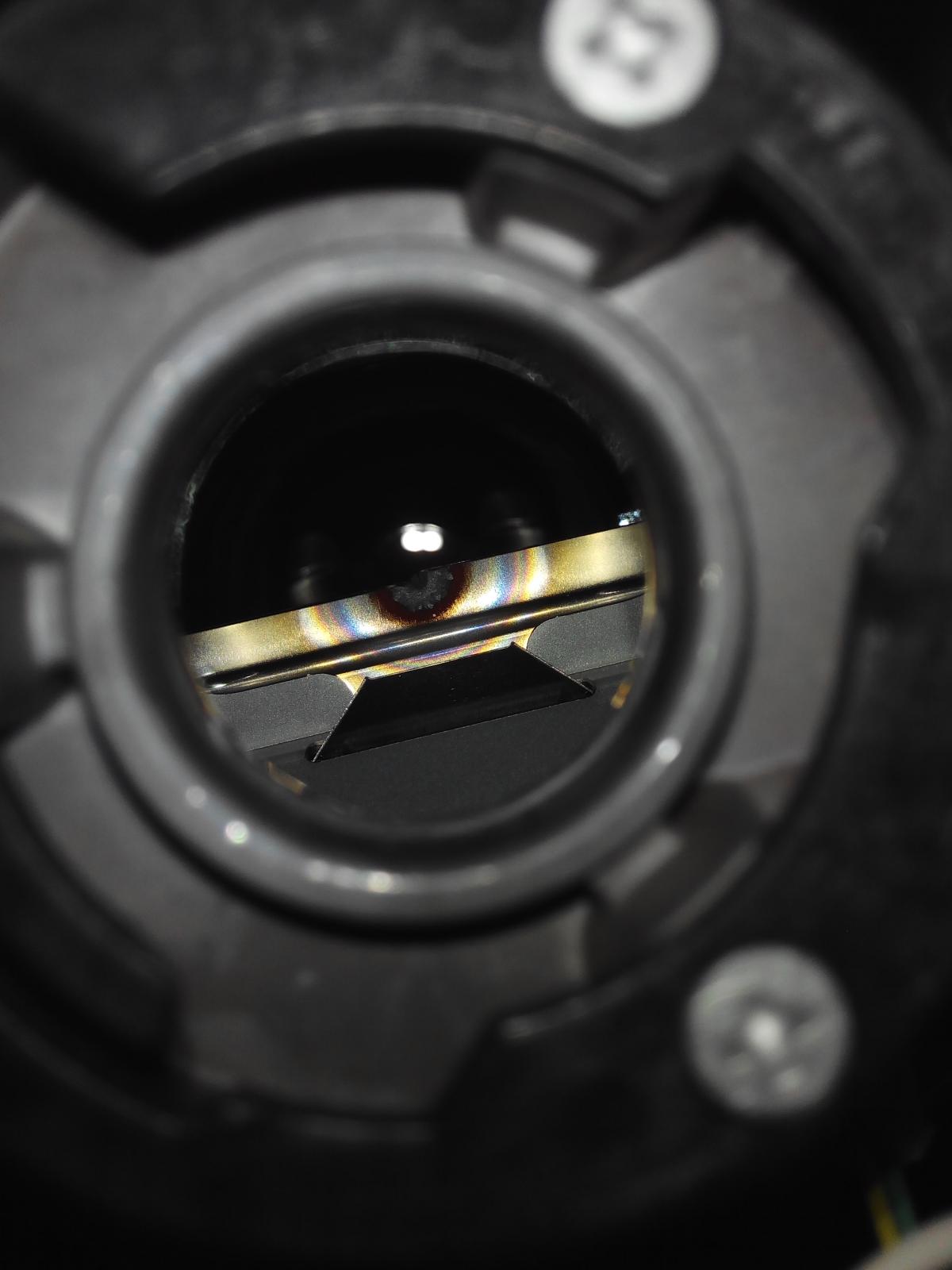

If you remove the bulb and look inside of the lamp, you will see that the metal part that switch from high to low beams is burn.
I post this to see if the UK Auris have the same issue.
Attached some pictures to show you better the problem.
