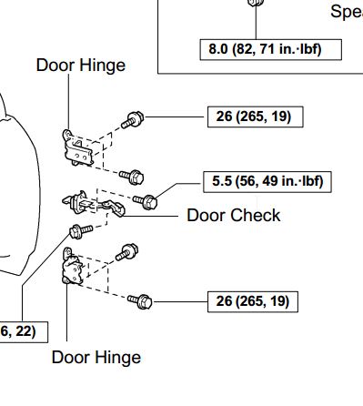

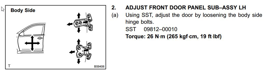

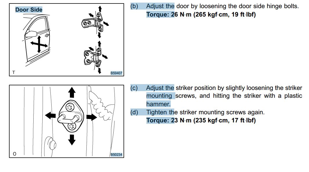

As mentioned never taken the rolla door hinges apart, but these diagrams from a 2004 model might help - though not sure which rolla/country its from.
Looks like the hinges are a bolt on part, so would suggest your first visit is to your local Toyota dealer , and with your reg no. they will be able to print out door parts page and show you what is available and at what price.
Some T parts are truely expensive but some T only parts, as I expect the hinges are, might not be too bad.
