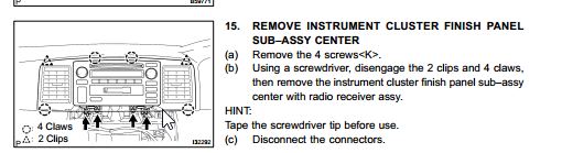

Once the power / Battery has been removed from the unit , its the same as if its physically removed.
As you can see from the owners manual , there is no mention of any code.
post-95973-0-01680700-1448140197_thumb.j
