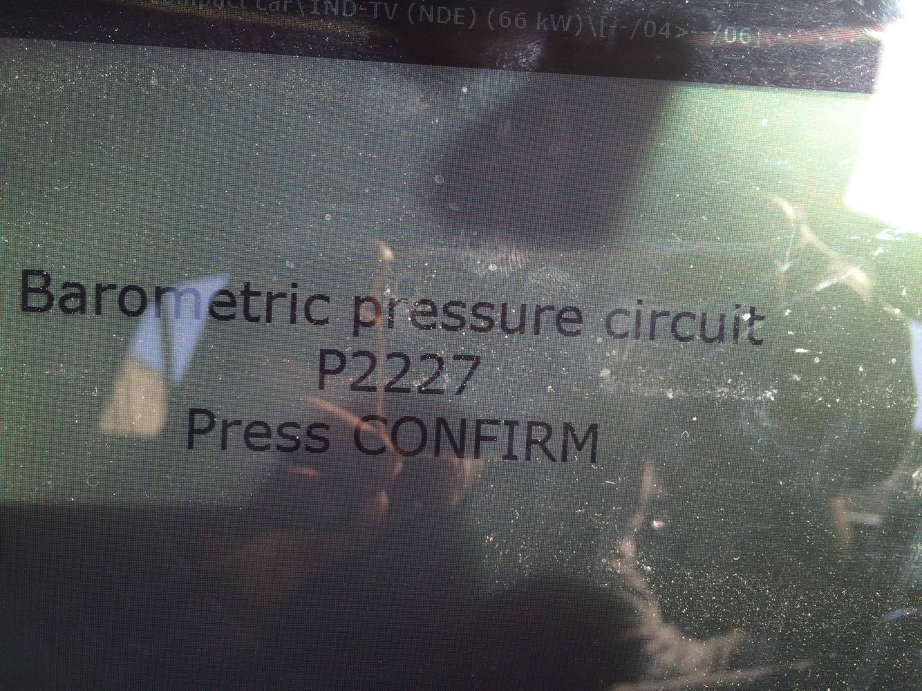

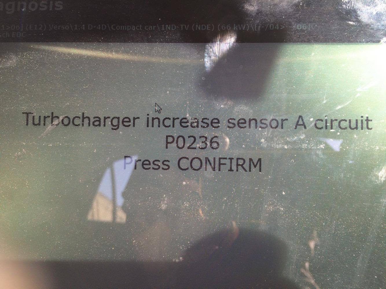

We've got a Corolla for repair that is giving us the errors on the attached images.
(P2227)
(P0236)
After resetting the errors, they just came back and the engine had a change of sound, kind of limping.
Any help would be greatly appreciated.

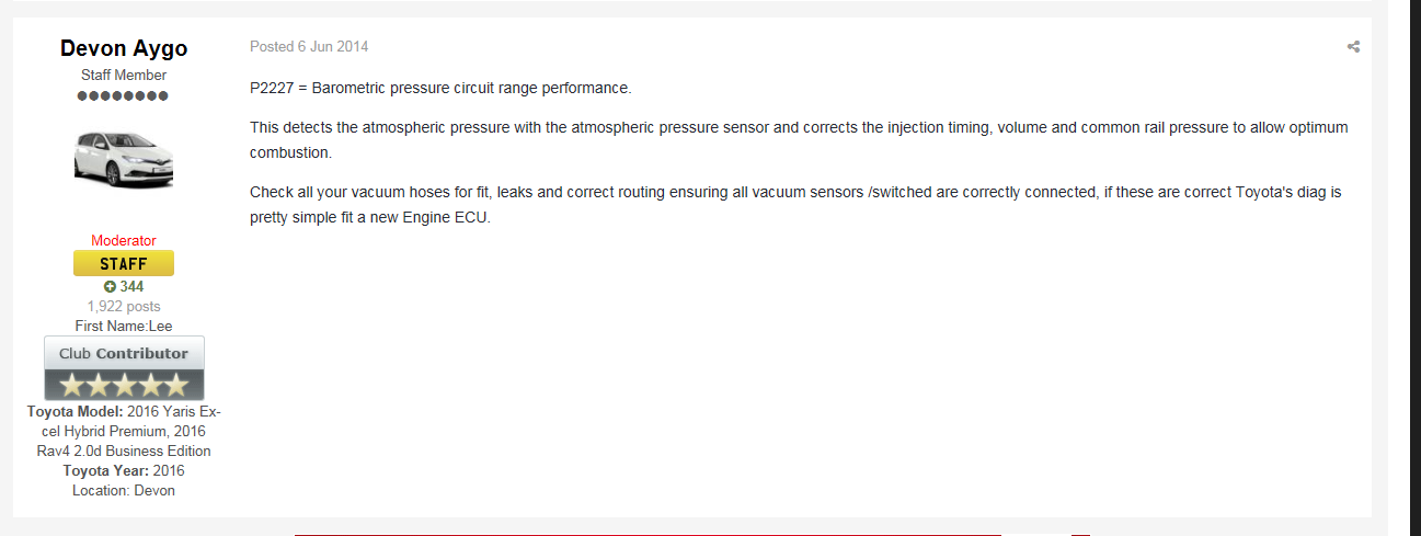

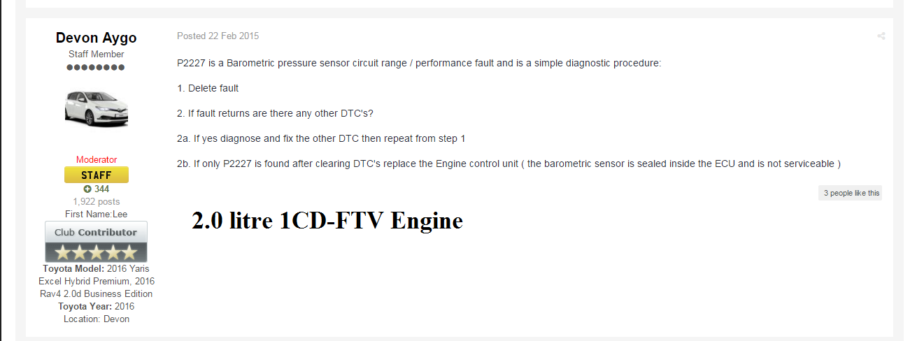

Devon Aygo posted a reply some time back about the P2227 code (see attachment) but that was for the 2 litre 1CD-FTV engine whereas you're working on the 1.4 litre 1ND-TV engine. Maybe DA will be in later and give you better advice.
