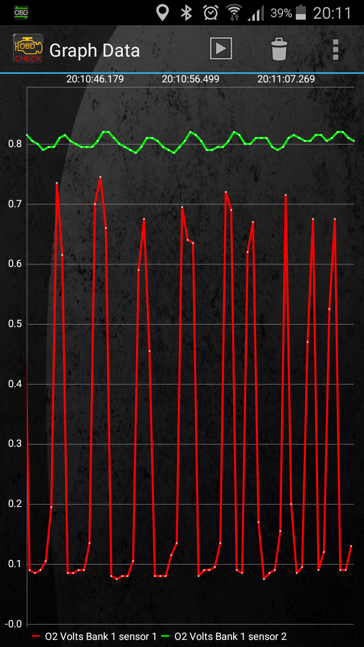

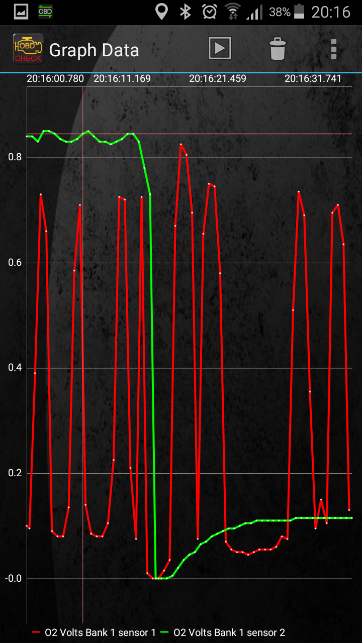

When parked, the post cat o2 is high at idle rpm or low a when rev is 2000rpm.
above is when at idle around 650rpm
this one is when I blip the throttle to 2000rpm.
I am yet to find out where this constant line should be in a toyota. I checked my brothers car,  a corsa 1.2, his post cat o2 is in the middle with tiny fluctuations around 0.45v.

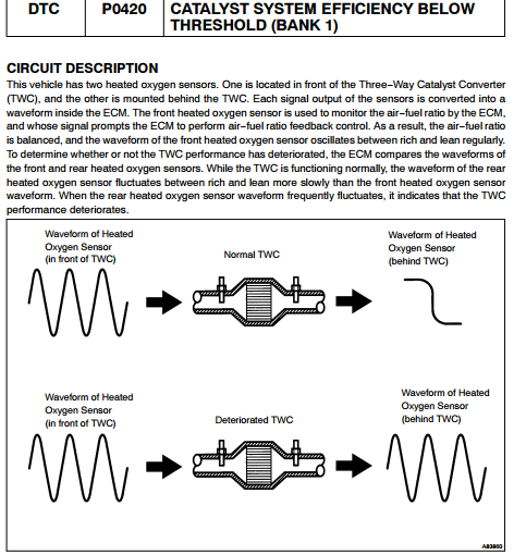

Taken from Toyotas diagnostic info for P0420
