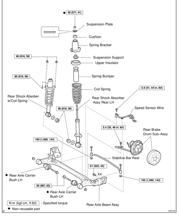

problem solved the noise is traveling from the back of the car it a long bar that comes from the body of the car to near the rear wheel not sure what its called but finnally the problem has been found thanks to my son
Shows how deceptive such sounds can be.
Which part is it thats knocking  ,  just a loose bolt or a worn bush ?
not sure which piece ,it goes from just below the rear drum towards the front of the car my mechanic is on it at the moment he never looked at the back because i insisted it was the front and with it not happening when he is drives it he wouldnt have picked it up

no sorry have not had the chance but my mechanic has had it up and greased all the rubbers and cleaned everything and its still knocking so im going to have a look at the rear shock mount on the boot when i get a chance if i thats not it im just going to put up with it till it either breaks something or it drives me to scraping it lol
