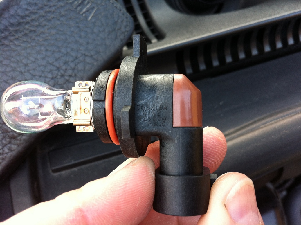

One thing i noticed though about the old bulbs, apart from the fact they looked absolutely knackered at the bases, the tips were covered with what i can best describe as grey paint. The glass was also a completely different shape, instead of being a long cylinder with a tip, its more like a traditional house bulb with a tip, just struck me the difference between the old and the new, but i guess as with anything they've improved them since they first made them.

The original bulbs in my car were made by Toshiba and it sounds like you had the same type, quite a different look to them.

yup, thats the type! Both of em are now acting as spares :smile:
