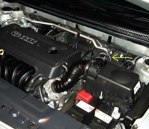

Will expect to see pictures looking better than mine then ...  :smile:
That pic was  back in 2011 a year after I got it s/h,  fitted with a Delphi Battery which soon expired,  your 13 years old ..  thats pushing it , probably replaced once ?
Fitted a Bosch S4 in 2012, been fine so far;  start up crank always strong
