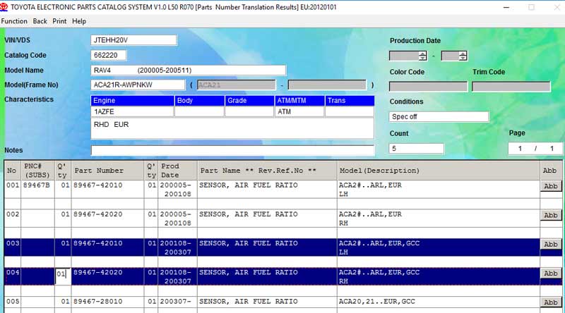

EDIT:  Ah-ha - Found this on EBay:
Bank 1 Sensor 2
Even less, and a Denso part
Ignore the EPC pic below.   I can't find out how to delete it.  It refers to the upstream sensors (sensor 1). Quite ridiculous that the name and description omits that fact.
It turns out that the upstream sensors are "Sensor, air fuel ratio", and the downstream are "Sensor, Oxygen". I think I can hear Michael Caine saying "Not a lot of people know that".
