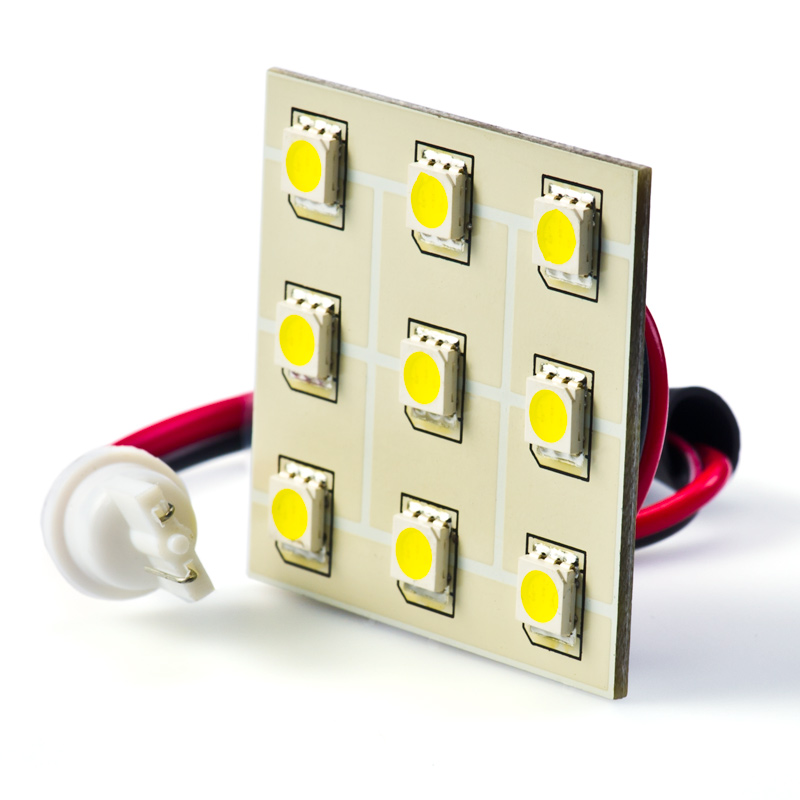

Unfortunately not. They are not bulbs in the conventions way and don't pug or screw in. They are soldered directly to the PCB as in the photo below ( this is not from the interior of the clocks just a random photo of some LEDS )
