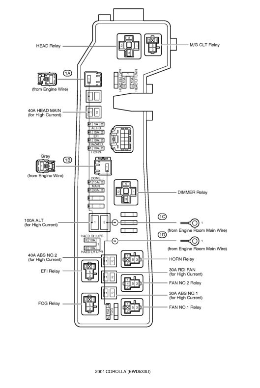

This pic might help locate the relays, though its from a US manual, so there might be some different /extra bits
Well just double checked the fuses in engine bay for h/lamps,pulled them out popped the back in all seems fine,but shall see later tonight as heading out fingers crossed,thanks for diagram oldcodger.
