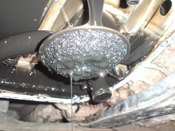

The picture is not my oil pick up... but it looked the same.
Don't know if it answers your question

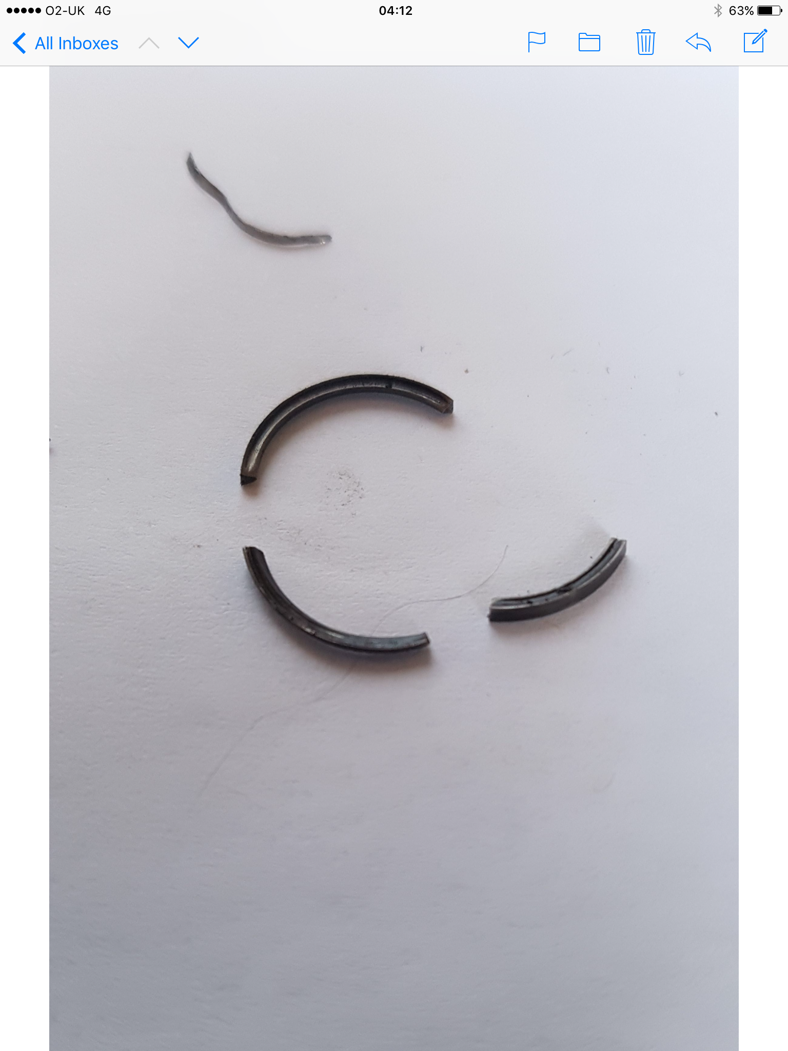

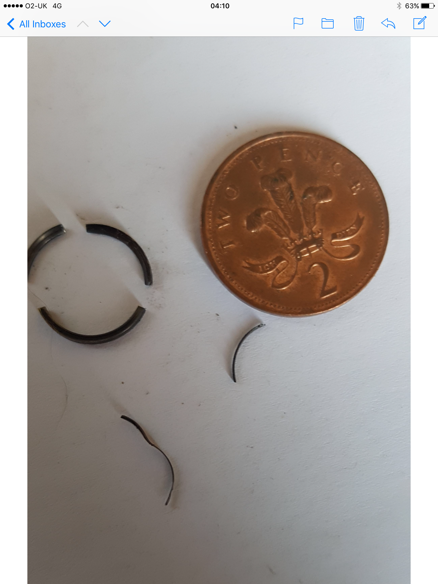

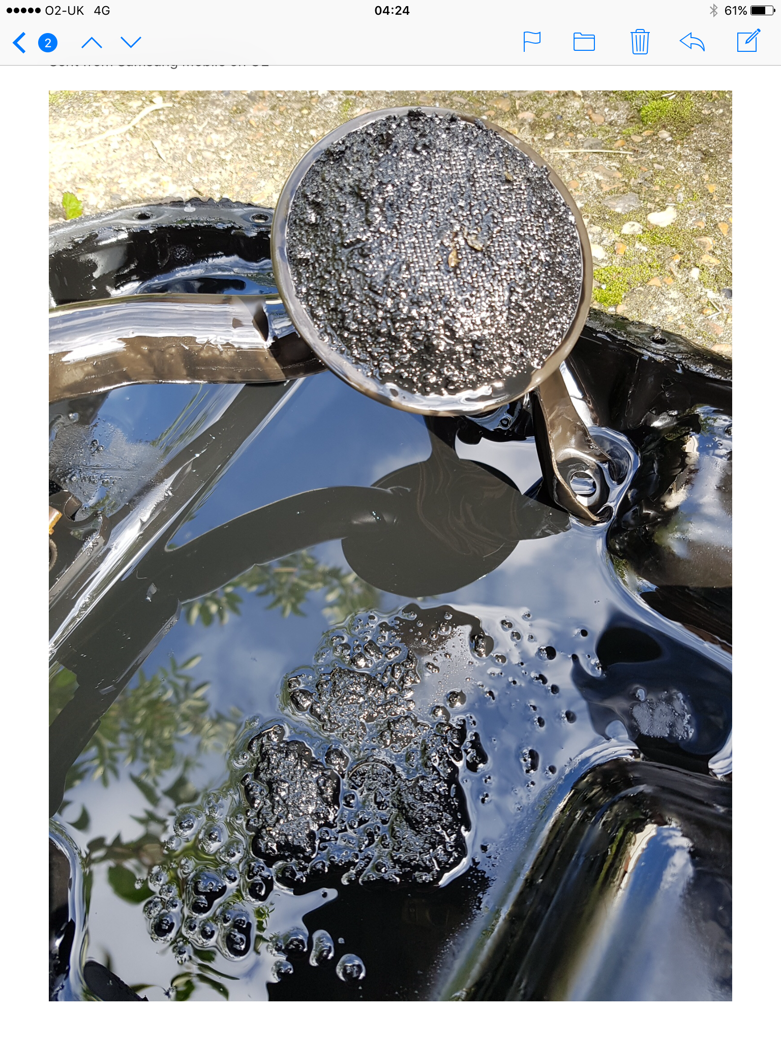

Bottom end knock = big ends maybe? Con rod? Dunno, new turbo is ok, pressure light not strait away, that oil pick up looks the same as mine was. found this in the sump, not a clue either what this was either, just wanted to ask if it's worth doing? If so, how easy is the baffle to remove to check the end shells? Bearing in mind, I'm not in a garage, and I'm crawling about on my back under the thing
This was the gunk in the sump, just wanted to add, I've done oil/ filter change every six months regardless of mileage since I've had it (5 years)

Hmmm... can't figure out what the thing is that you pulled out of the sump.. but the oil pick up looks like s... thats for sure.
