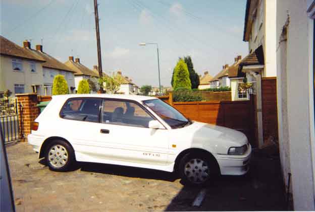

found a pic of my rolla just after i got it 6 years ago.
my how times have changed. not many of the original bits lft on it now
Lee - you bought your GTi at about the time I part exchanged mine for the SR - I wonder sometimes what happened to it.
i know. i got a load of magazine reviews and advertising material from eBay.
looking at the GTi's featured and wonder if any are still on the road
