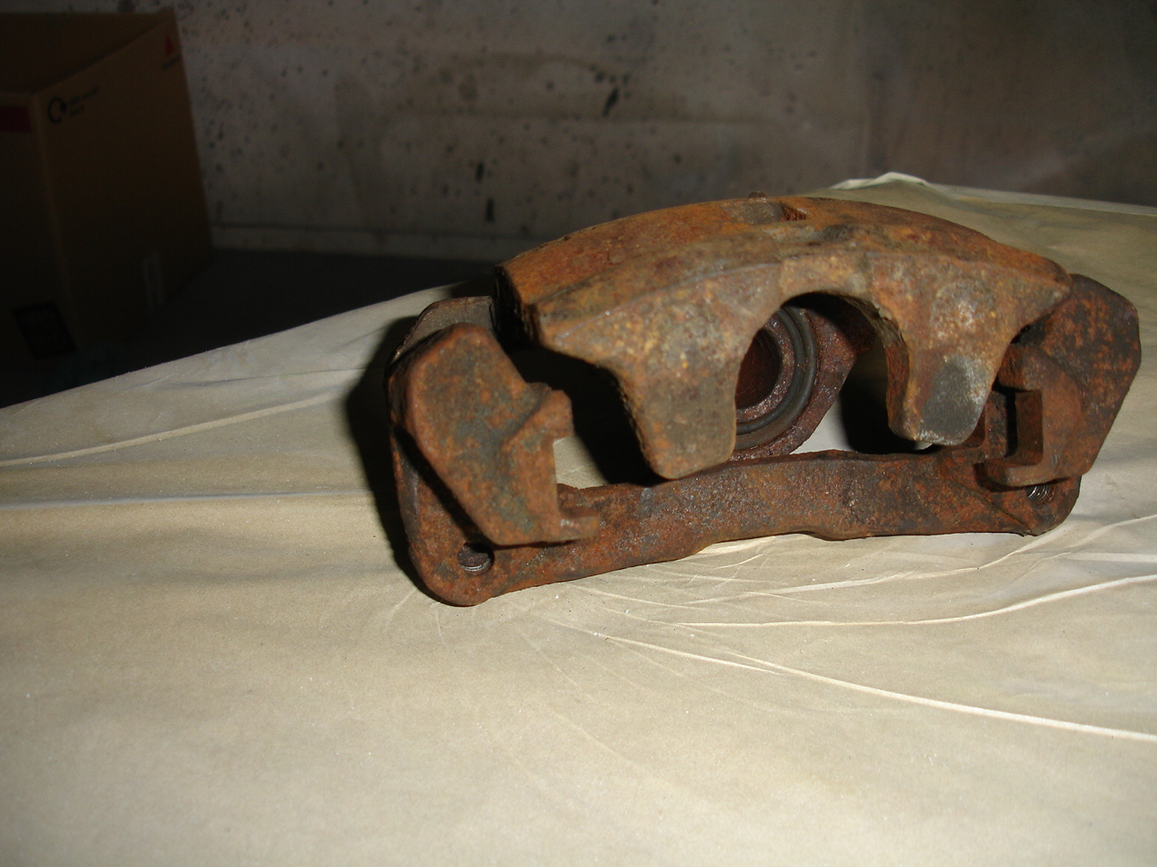

Been overhauling the G6 rear calipers I recently got. Look to be in good nick.
Grit bast to remove all surface corrosion, and paint red - really love the Plastikote Bright Red, good strong paint. Been on the wife's IS200 for coming to 3 years now and no sign of ageing/heat damage - the way I drive. Twice a year the calipers get a coat of wheel wax and always easily wash clean.
I'll get some pictures on soon.

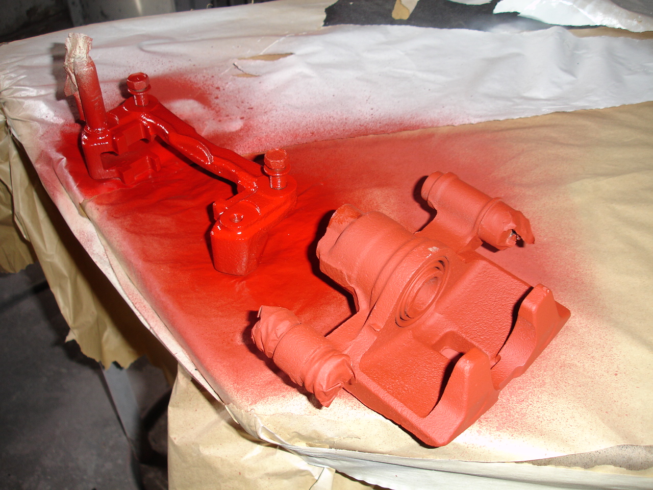

Here is one of them grit blasted, red oxided and getting a coat of red.
Can some one turn them to pictures please.
The discs I got with the hubs have been refaced and will be prepped before being fitted to the hub along with the calipers.
