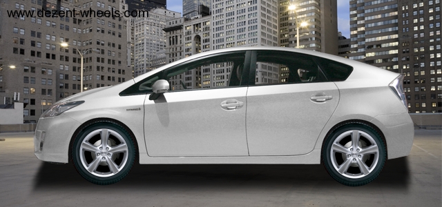

Does anyone know the weight of the toyota 15" wheels and the 17" versions...
I've found some lightweight alloys but like to check whether I stay within the limits...
In the mean time what's the opinion of those aftermarket wheels :-) I do like my sun roofs....
These are Dezent one's, and I've found several Kei & Kato lightweight wheels as well....
