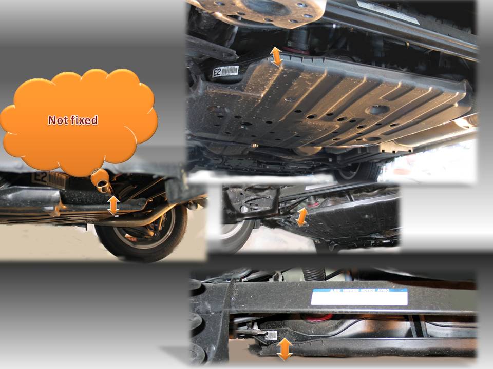

Have a look to the plastic part below / under the tank. (picture shows LHD)
One corner is not fixed.
On high speed (Autobahn!) it sounds sometimes like a bee.
It could well be this that is the culprit. Any ideas how to stop the aforementioned flapping.
