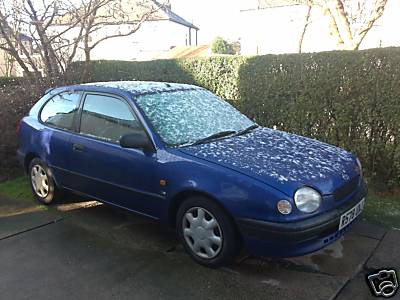

I'm looking to add something new to my car any ideas where I should start with some upgrades? I have the E11 the earlier model with the rounded headlights. I'm looking for both engine upgrade (i've seen a lot of air filters etc in ebay) and body upgrades. Anybody know where I should start and give me some deas of what to look for and where to look. Much appreciated.
