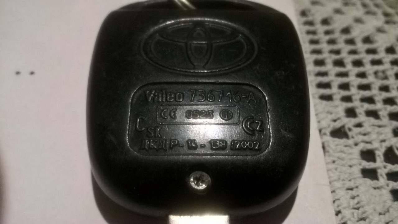

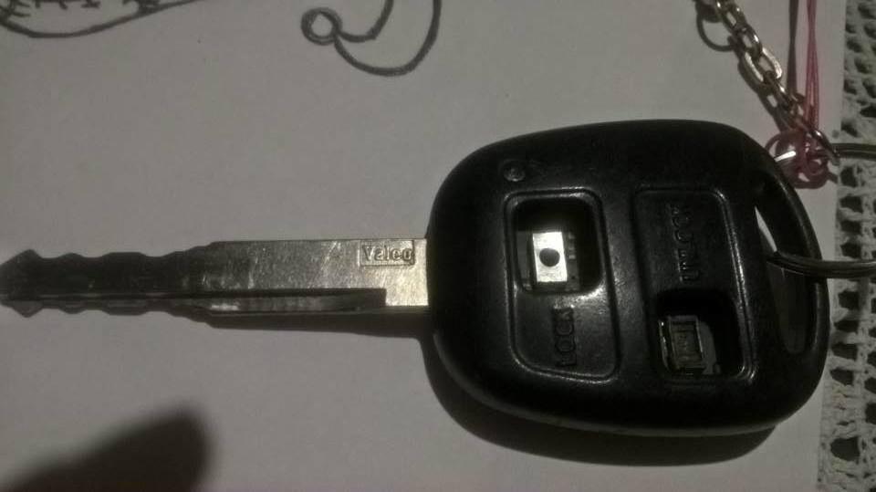

HI ,there,
i am the owner of a yaris 02 model and bought a used key from ebay, like my damaged old key IS-3422-00.I have to say that following the instruction of (nwc 100) the key worked.Both the remote and imobilizer.THANK YOU VERY VERY MUCH!!!
Panagiotis
I have a Yaris '03 and I have only one key. Does anyone know if these keys from eBay work? can I program them?
And what the chip 4d-67 means?
http://m.ebay.com/itm?itemId=191977345737

There are (IIRC) 3 different possible types of remote for the Mk1 Yaris - I think they are Denso, Valeo and Tokai-Rika - so it's not possible to know from the info you've given. What does it say on the key you have?
It is Valeo.Here are two photos.And i really thank you for taking the time to help..
Hmm, from what I can tell the eBay one you posted won't work - I *think* it is a Denso, but the posting is sketchy as heck - It shows a 2 button key, but a 3-button module!
I'd look elsewhere...
