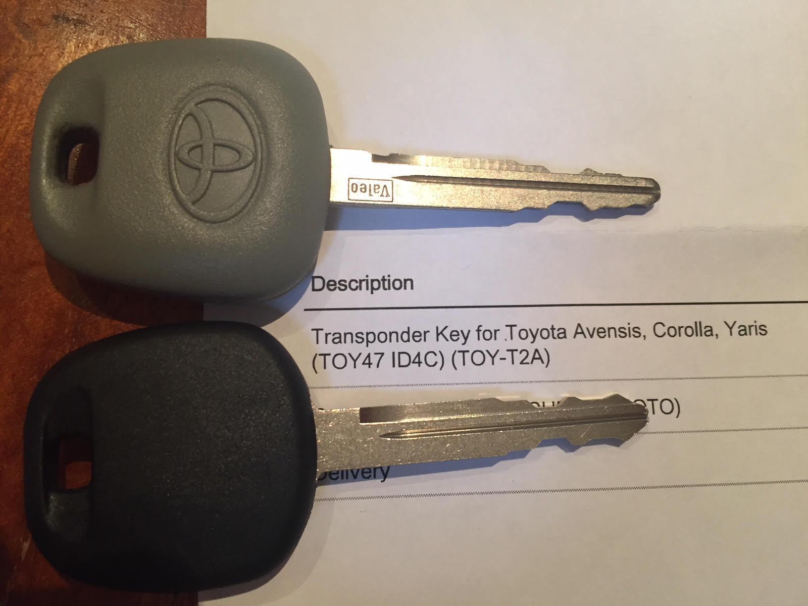

Thanks for your help, ordered a key from car keys online using VIN number with a photo of existing key for checking arrived next day and followed the instructions previously listed and had a working key for £28.00. What a result took 2 mins to program 👍😀

I’m not sure about the MK 2 I just bought a Valeo key for a 2005 mk1 and it worked fine. What I did was I went to a local breakers and they agreed to let me try the reprogramming if you have one local maybe worth a shot
my local breaker had a bunch of Valeo keys if you don’t have any joy elsewhere let me know and I’ll get you his details
