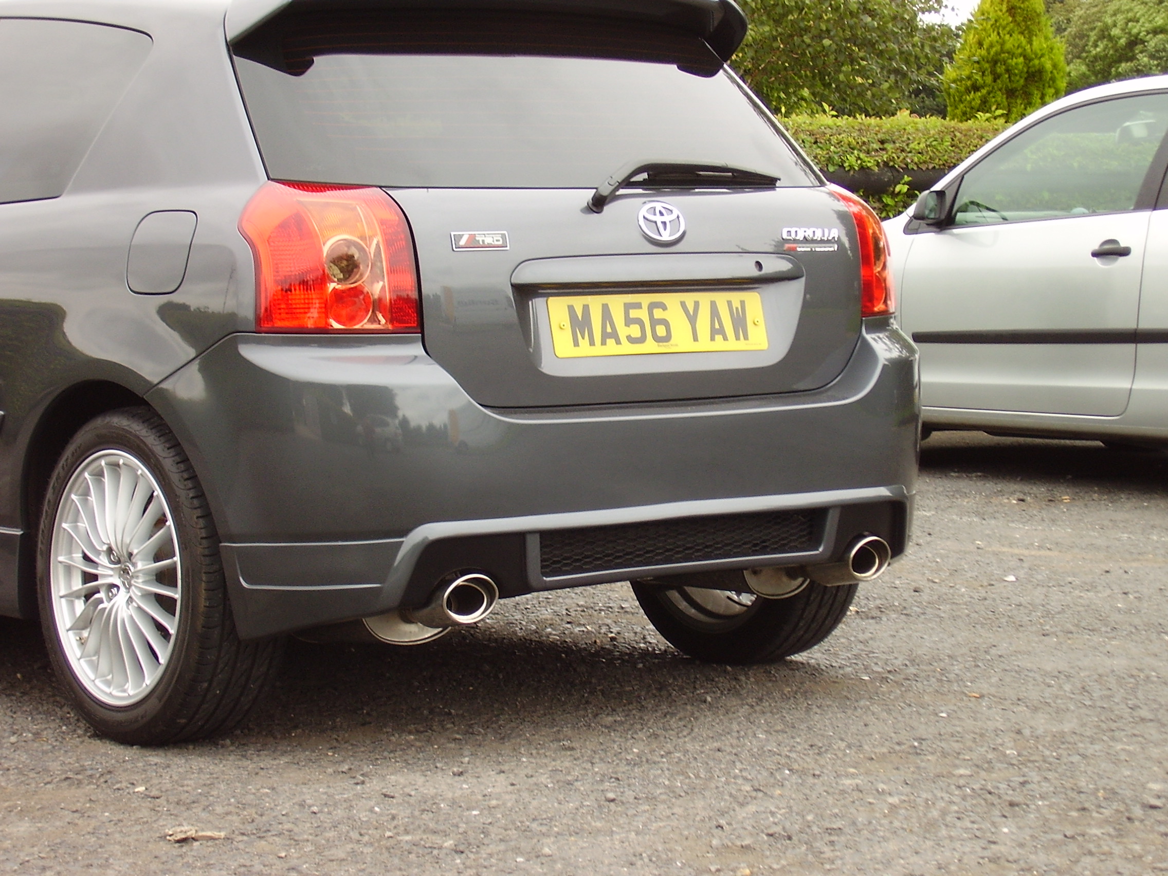

today the compressor went in for a measure for her new custom ss exhaust. with money being tight im doing it section at a time this month will be 2 x custom made backboxs keeping the original tte tail pipes as to try to keep noise levels at a reasonable level.next month will be to the rest of the pipe to the manifold changing the center cat to a small box keeping the lambda's sensor working without getting engine fault codes( tryed and tested on a yaris tsport) while at SC performance the guys had a poke around under the bonnet and come back with moving the Battery into the boot, thus having more space to bring the k&n closer to the front of the car in the space where the Battery would have been, then a cold air feed brought up from behind the fog light but keeping the foggy working just drilling around the black fog light surround with enough bend to stop water being sucked up. the guys suggested taking the supercharger pully off and to make a bit smaller but having to look into that as not sure if a solid pully would be a good idea or a bad idea either way if it needs a electromagnetic clutch type or not they can fabricate one for less then £60. i will post pictures up of the progress as it happens. :yahoo:

get some 5-3" on the back they look mint and fill the bumper nice. :yahoo:
Sweet! Loved seeing you blast off in that thing! Was a seriously quick motor. :thumbsup:
Now it will hopefully sound just as good as it goes. :D
indeed, my bodge on welding up the original tte back box has started to get on my nerves which got me down to SC performance today. day off well spent :thumbsup: . it goes in monday to have the exhaust done so will post some pics then. cant wait!!

these guys are making this center box from scratch. will take some snaps of it when its finished,
nice mate, i had the tte tailpipes polished up and fitted back on to my system, as they look plush in the arches and have a slightly golden finish. How easy is it to move the Battery though?

keeping the original tte tail pipes was the 1st thing i said... hell they loooooooooook sweeeeeeet

ok so the beaut has gone into sc performance for the price. £290 for the rear section 2 x custom box's piping and labour cutting off original tte tail pipes and weldingthem onto the new back box's and a few other bits. so she goes in tuesday morning for some pampering. the center section is still being designed by the boys at scp but should be no more then £250.
