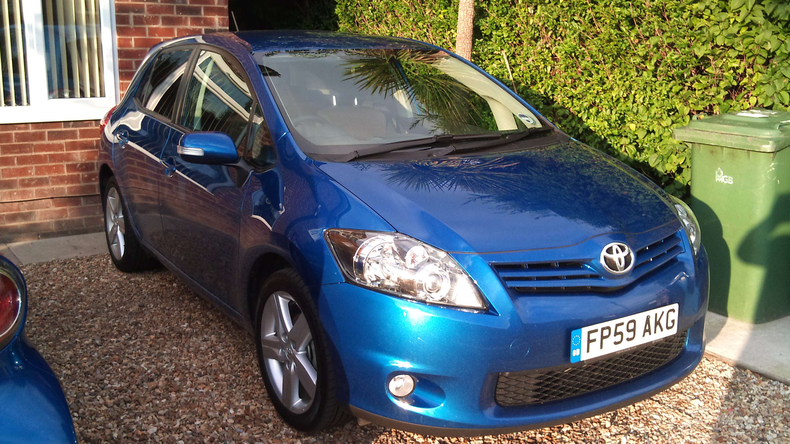

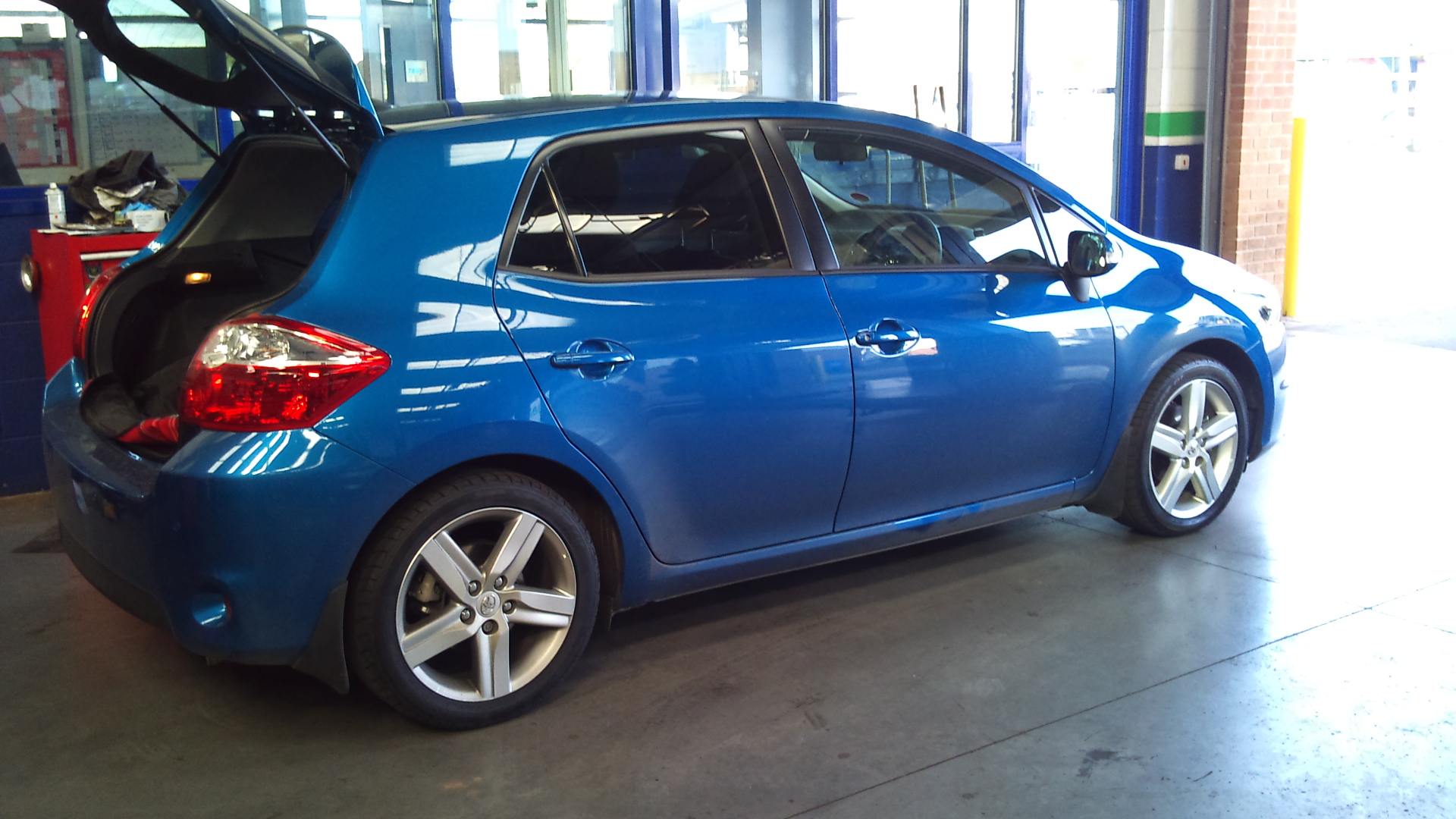

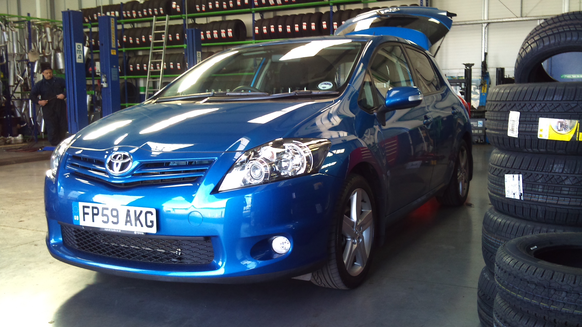

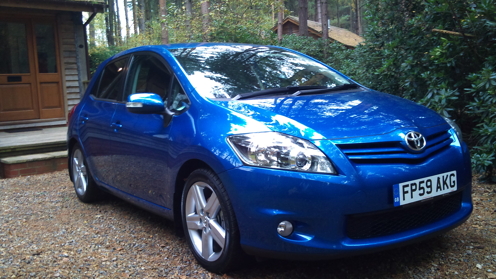

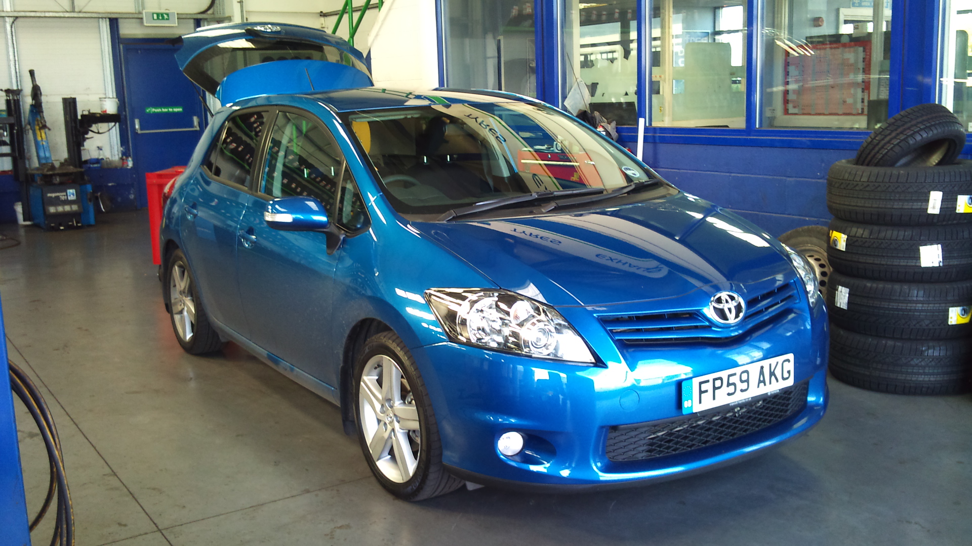

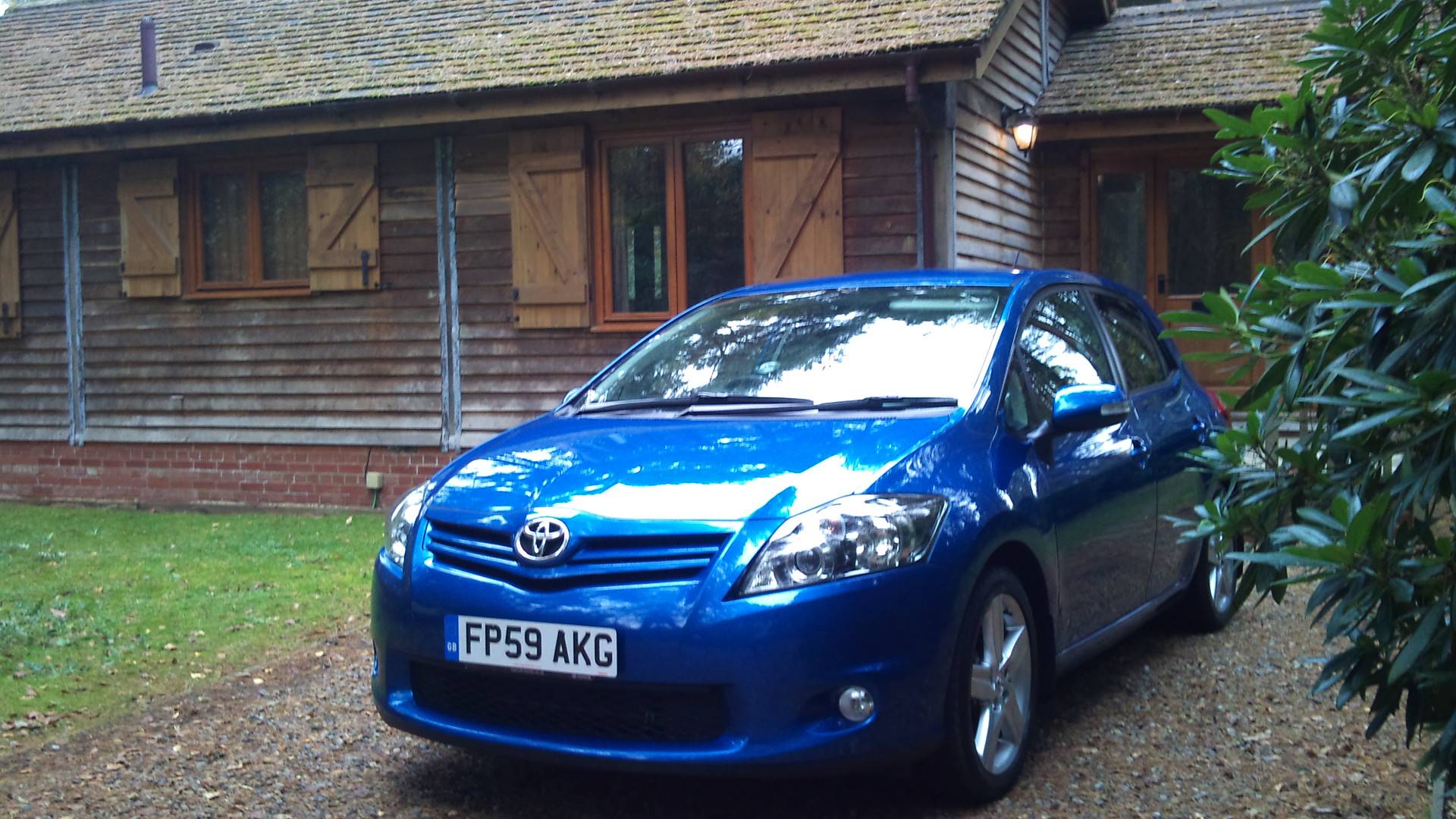

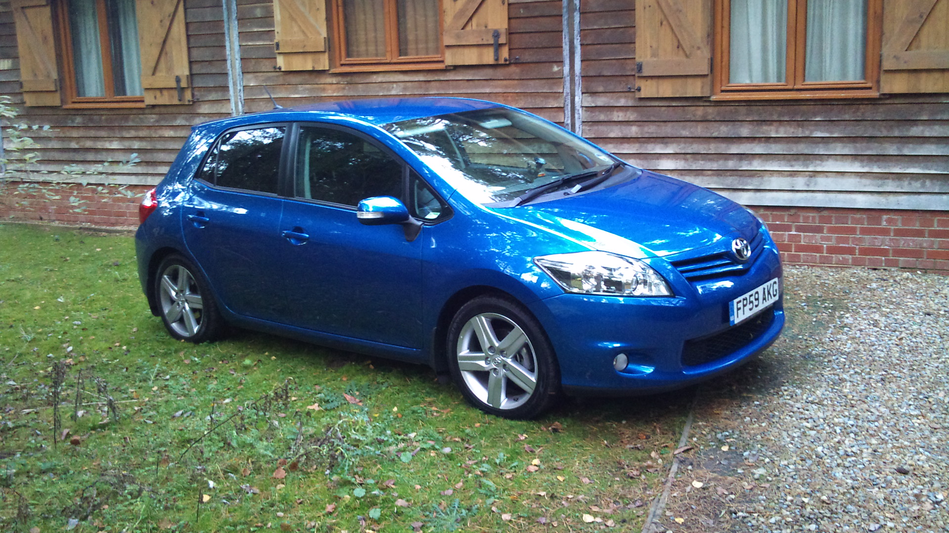

these r the pics of the Auris lowered 30mm, didn't drop it as much as i hoped but it sat much higher then most face lifted models for some reason.
i cant drop it much as i live in a area where there's lots of speed bumps but its made a difference on how it handles which is always better.
because its still under warranty i need to use genuine Toyota parts in case there's a problem with the car, i:e there was a knocking from the n/s/f shock and if i had after market springs then they said they wouldn't have sorted it out.

What is your impression overall? Did you have to get the wheels aligned afterwards, for camber, toe in issues, or not?
I want to install them but im not so sure if they improve the handling/response. The looks are almost the same, comparing your pics before and after. Maybe it is more noticeable at the rear end.
Regards.
hi aurum, its made a difference, it corners better and doesnt wander when braking at high speeds, and ya right it is more noticable on the rear but overall im happy with them, its also not much stiffer than the standard springs.
as for fitting them i didnt have to set the camber or do the alignment as i put the hubs back in the same spot where id already marked them.
the alignment moved 1 mm but mine was set at +2mm so put it right but would have done it at work if it was needed, but i would get it checked tho to make sure it was set correctly
Thanks for your reply.
The car still seems pretty high :(
I was thinking of lowering my Auris as well, by using -35mm springs (H&R) but seeing this I think it's a waste of money (for me) and maybe I should save some more for a coilover kit :)

hi constantinkamal, mine are the standard wheels and are sat on 225/45/17 dunlop sport 01 tyres, will be upgrading them to dunlop sport 01 runflats when they need replacing as mine dont have a spare tyre :ffs:
grts
hi, for some reason my car was very high off the wheels aroumd a 4in gap which was more like a 4x4 truck, it was difficult to wash the roof it was that high, im nearly 6ft so its dropped it quite alot from the standard ride hight, but yeah its still a little high but im happy with the way it looks, and its great on corners
