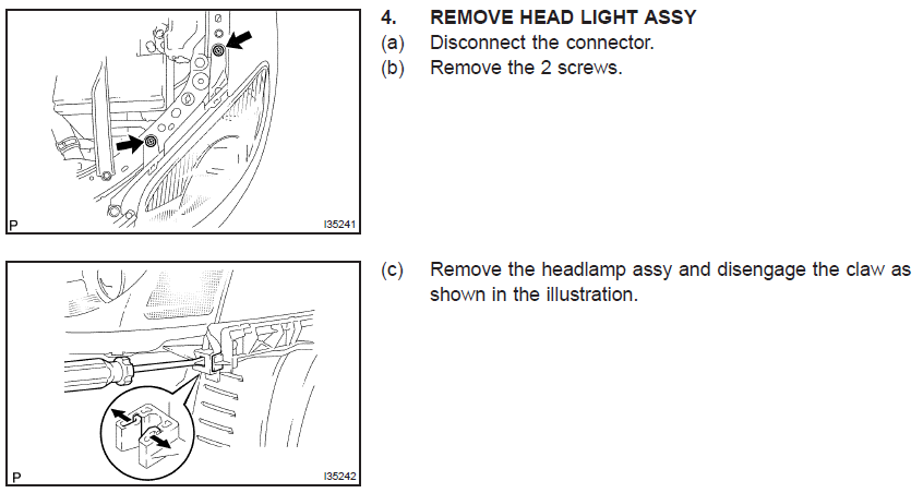

Thank you for the tips. My new problem is how to get to the light holder. It seems something simple; use a flat screw driver and twist anti clockwise and pull it out. That worked for only one of the screws. The others didn't come out and I feared breaking the screws if I forced them out by using a screw driver and lift them. Any suggestion as how to take them out? would lifting them by a screw driver break them as they are plastic in nature? thanks

Here's how the headlight is fitted.
