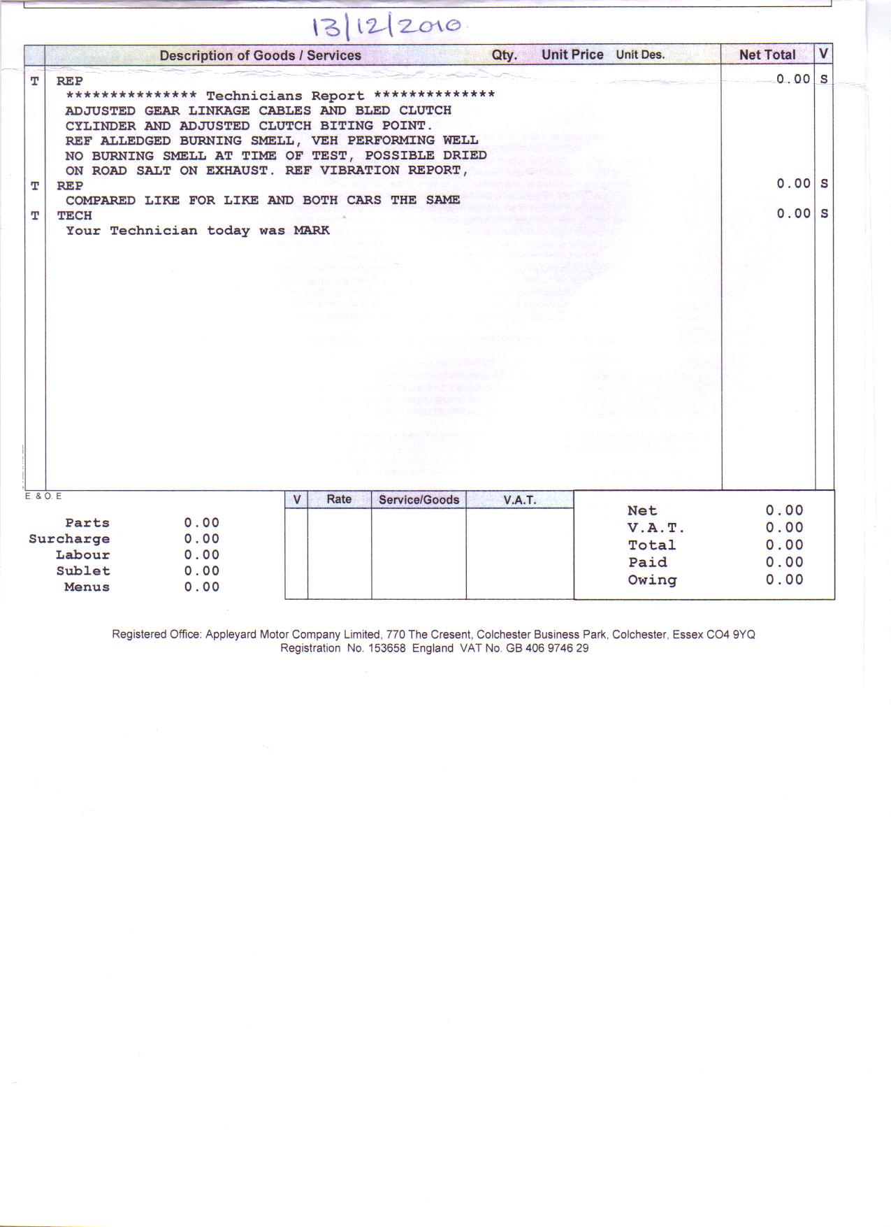

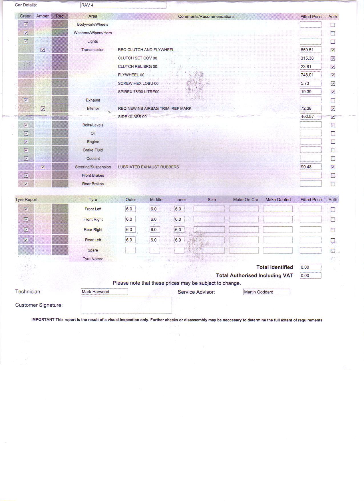

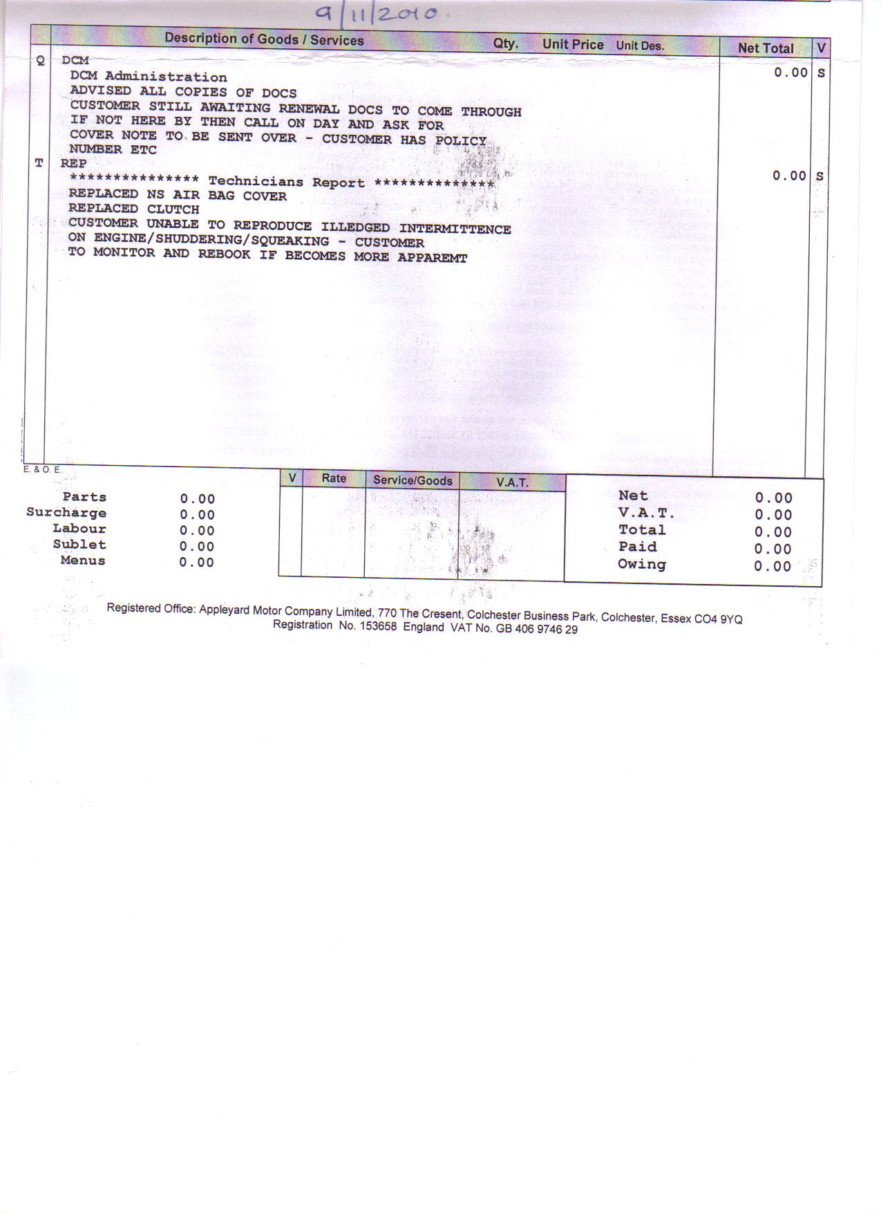

What the dealer said they had done the first time was a £2000 job, a full new clutch system and fly wheel replacement. This time they said they have done some fine tunning on the clutch, and then said this would slightly adjust the bite point. It doesnt feel any differents what-so-ever!!
Iv just bin on the phone to dealership and requested a comparison test run. Going through tomorrow to test drive the executives Rav4! They said its slightley newer than ours! but what he means by that I dont know. Lets see what happens!!
I have both job sheets if you want to take a look, but not sure how to attach the files on here!
Have a glance at the repair sheet files I have attached, see what you think!!!

Nice work - they filled it with the wrong gearbox Oil. It MUST have straight 75W Oil or it will be a cow to change gear. I have posted this so many times recently.
Is that write - straight 75W Oil ???
