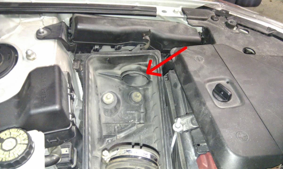

For anyone wondering, I attached a picture of the loose intake pipe. I fixed this by removing the bottom part of the box and wrapped a foam tape around the pipe.

Silicon sealant worked a treat for me - although the white stuff left over from the bathroom isn't the most subtle of colours!

Ty! it help noise gone! Happy days!
Toyota fixed this fault for me at 150,000 service for £28. First time I've had it from new. I love my T180 Tourer.
Just fixed mine and i'm well pleased thanks for posting this picture i was looking at the wrong side but now have fixed can't believe it EXCELLENT!!!!

Thanks to all on this annoying issue have sorted mine with a self tapper 5 min job complete bliss now apart from tyre roar that is !!!
