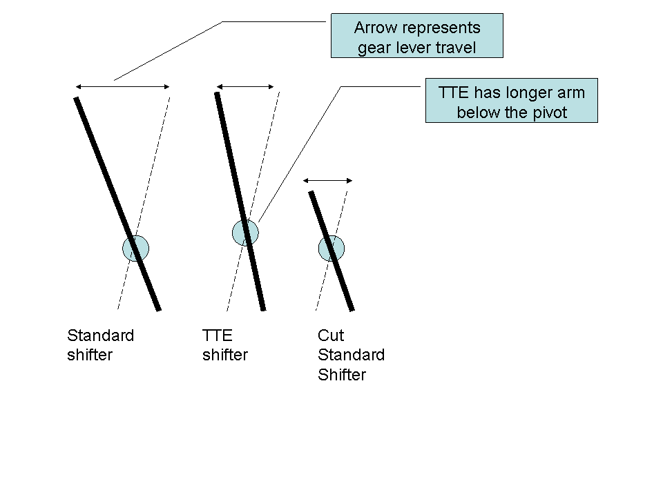

post-9827-0-65451800-1308648005_thumb.giThe basic problem is you think the shift shortening is due to a reduction in the angle of the gear lever. This is not correct, the actual shortening of the shift is a combination of the angle and the distance from the pivot.
TWM shifters have the pivot in the same place as the stock lever and the same distance below the pivot to the gear cables. The only difference is the length from the pivot to the gear stick which is reduced.
I have attached a diagram to show the difference. Note that if you cut the stock lever right down, although you have to move the stick through a greater angle, the actual travel distance - which is what you feel is much reduced. I have exaggerated the drawing but you can see the effect.
I understand your point (it is always nice to exchange useful and foundamental views).
I believe though that you are leaving something big out. The angle of throw is very important because by this way you can still change gears easily! With a short travel of the gear stick you still have the same result by using the same amount of effort.
If you just cut off the gear stick, you may reduce the travel distance of the gear stick, BUT you lose all the effect of the quick shift because you will have to apply the double amount of effort to change gear.
A quick shift means that you can shift quickly, not just have a short lever.
As you will see in the site of TWM, they propose that you should also buy a heavy (weighted) gear knob so as to assist you in the gear change. This means that the whole procedure is not being done easily (or even "properly") and for sure the tower and the gear cables will be suffering a lot of stress.
I bet that if we could make an experiment and we could count the exact time needed for changing gear with a TTE shift and a cut standard shifter, 10 times out of ten the TTE shifter will be much quicker (and with much less effort!). (This is because you said in one of your previous e-mails that they would have the "same effect").
As I said in two of my previous posts, why don't you grab the standard gear stick from a lower point when changing gears? You will get the feeling of how difficult and unprecise will be if you cut it off...
Yep you are right in that a cut down gear shifter will require more effort to change gear
but so will the TTE shifter, It doesn't matter how you shorten the shift, the net result is more effort will be required because you have less of a lever arm.
All short shifters work the same way, more effort to give less travel.
hate to throw a spanner in the works, but to add to the discussion, the TTE base bushes raise the cage also, so this would also have an effect on the height of the pivot...
Also, you have to take into consideration the force that is applied to the bottom of the lever.
This is known. It is the only way to achive smaller angle of throw (and this is why the TTE shifter is longer at the bottom - so as to reach and clip on the shifter cables). See my scetch in post No12.
