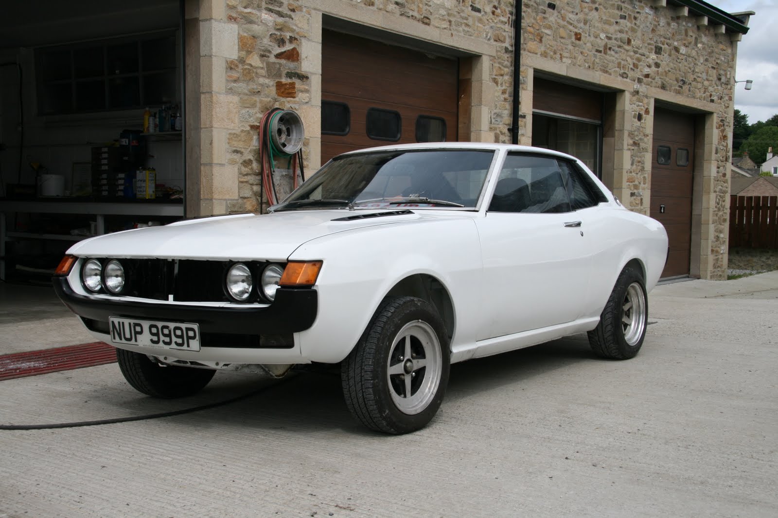

BrianGT
Many moons ago I used to be a Toyota mechanic.....back in the days when you could fix them with a penknife and a bit of string and the std oil was 20-50 mineral oil.
30 years later and picking up the tools again having restored a TA22 I'm wondering what oil to use.
The engine has Group A cams, 45 Dellorto's, 4 branch exhaust and is lightened and balanced so it can rev a bit...
The new oil terminology scares me rigid!!! :blink: 5-30 seems like water to me!
At the moment I am using Millers classic 20-50 but can't help wondering if a more modern synthetic oil would be better?? And in what way?
Help please!
Thanks........Brian

That looks like a nice motor. The modern double ester oils have a far higher TBN(Total Bas Number) for engine wear protection along with a higher Flash point and viscosity index. Have you taken a look at the Opie Oils site as they have Motul 300V oils on very good deals. I use the 5w-30 in my Polo TDi. Tim from Opie Oils would be a very good point of call to answer questions.:thumbsup:

Thanks for the compliments about the car Mistermena...it's appreciated!
I did look on the Opie Oils Forum here but didn't find anything relating to a really old engine but I will give them an email and ask for advice about modern oils...I'll also checkout the website.
Seems like lower viscosity synthetic oils still offer way better protection.....I'm going to do some reading up on it!
Cheers mate........Brian
