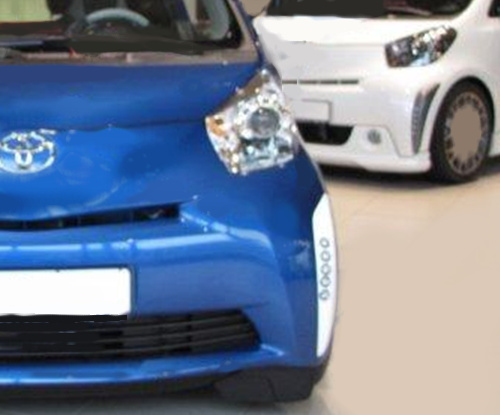

Very nice. A lot of money. I take it then you are looking to fit them in the lower grill area. The lights wiring loom can be a bugger to get into with all its covering. So to comply they are on all the time but dimmed when you normally have your side lights on and the sidelight bulbs are replaced with a load resistor. to satisfy the CAM BUS Ok
David
So do I take it that with the smaller units you dont need to replace anything with load resistors?

Toyota (Germany) has "official" lights!post-78587-0-17334800-1322510232_thumb.j
Yes LA-LA, that is true... but they are offered without mounting...
And it's very hard work to get something square shaped, on a rounded surface, behind the plastic front, in front of the plastic wheelcovering, into a "cut out" place...

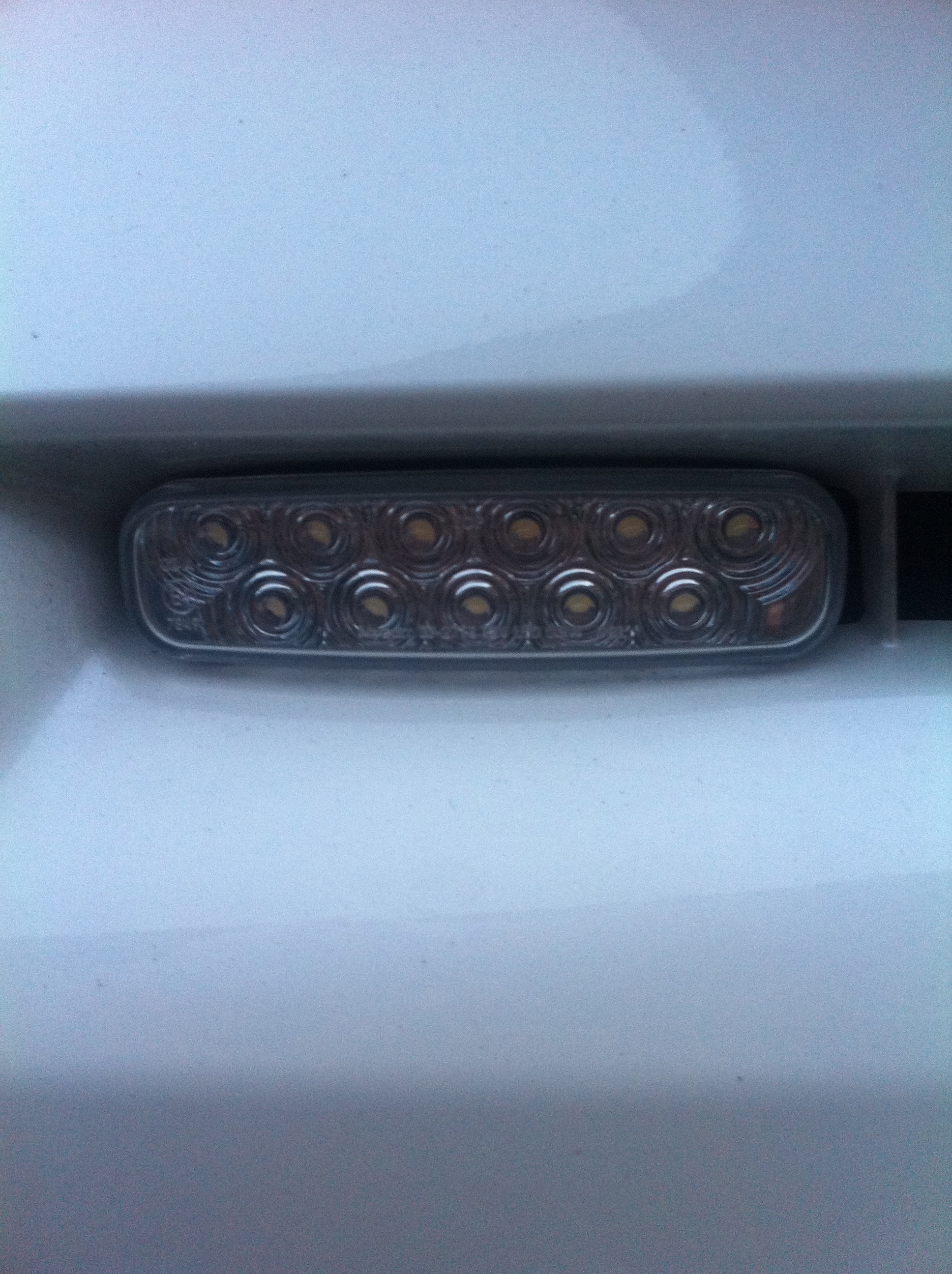

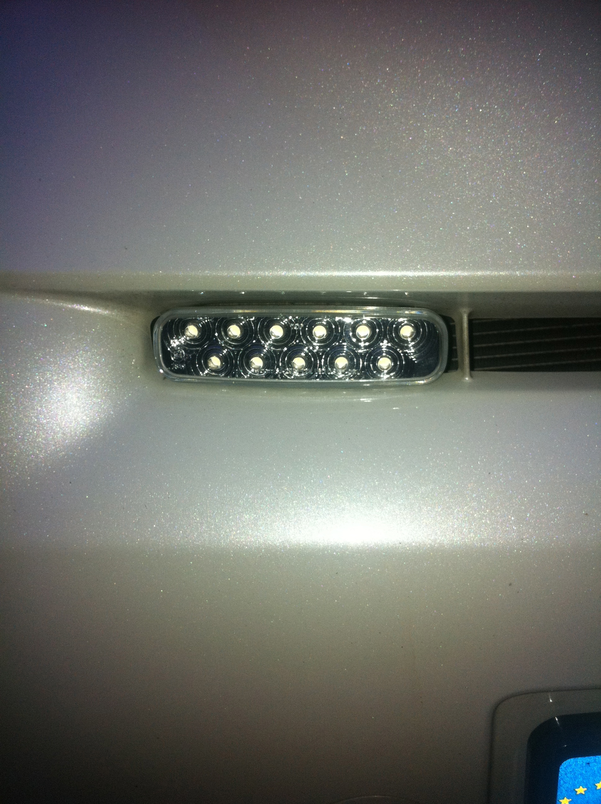

I have fitted at least 3 of the Ring BLR 0395 DRL' from Halfords into the upper outer most grill where they fit perfect. Also fit the associated automatic switch which can be found here from amazon. http://www.amazon.co.uk/gp/aw/d/B0045HYGZ4/ref=mp_s_a_1?qid=1338845501&sr=8-1
A very easy install can give you instructions if required
There are pictures of mine on the revious page. And NO MrT have never refused any warranty work i have needed. Even though my car is heavily modded

I fitted these this weekend, dead easy with just 3 wires. The DRL's come and off with the ignition and also go off when the lights come on and come back on when the lightd go off. You can alter the wires so that the lights only go off with the ignition and not with the lights.
I fitted these this weekend, dead easy with just 3 wires. The DRL's switch on and off with the ignition and also go off when the lights come on and then switch back on when the lights are off. You can alter the wireing so that the lights only go on and off with the ignition and not with the lights.
603099_4115222884687_993232467_n.jpg282306_4115221124643_225910692_n.jpg428499_4115219204595_1630957258_n.jpg
Hi Tony the unit from Amazon consists of 2pair of wires with bullet connectors on which match up with the ones on the DRL's the other 3 wires are, Black to the chassis or direct to Neg of battery, Red wire direct to the + on the battery and orange wire to the green wire on the side lights. The unit has 3 chips and a power transistor and various components in it. On engine start the DRL's come on. When the side lights or main lights are put on or come on if on automatic, the DRL's go off. If the DRL's are on and you turn the engine off the DRL's stay on for a further 3 seconds. So yes the unit senses when the engine is running and when its not. So no need to worry about switching them on or off its automatic
