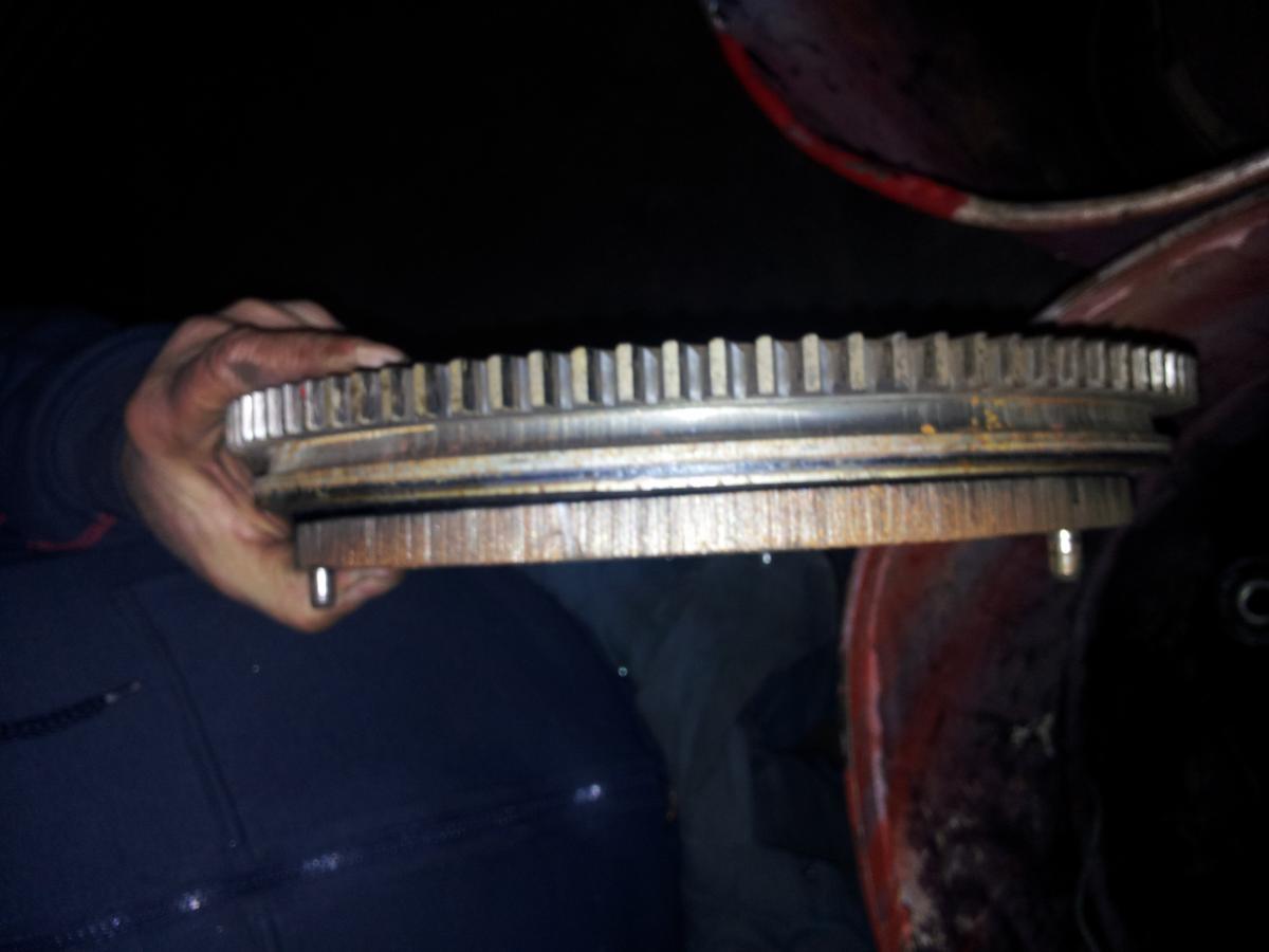

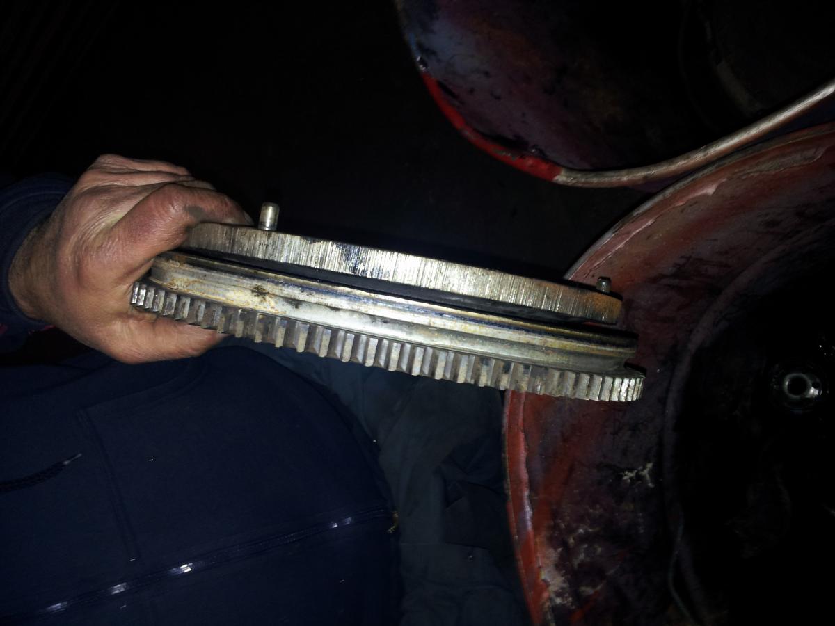

Help needed i have a 2004 avensis d4d t sprit with 80,000 miles on the clock full service history my problem started before xmas the car would not start when warm very odd but once running it was fine no sign of any problem no engine management light on, then it gradually got worse i had the fuel filter changed the egr valves cleaned no change took to a diesel specialist and was told dual mass has gone need a new dmass a new clutch and a new starter ouch quoted £1100 anyway took the car elsewhere and had the clutch and dualmass fited £700 bargin.(pic of old dual mass attached it sounded like a box of spanners rattling it had colapsed to one side ) anyway i still have trouble starting hot or cold will a new starter motor cure this or is it something more exspensive. when the car does start it drives brill no power delivery problems it goes like a !Removed! train. i forgot the Battery is a year old and glow plugs were done at same time
