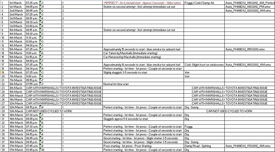

It is approaching a month of ownership and the vehicle has problems starting. I reported it to the garage two weeks ago and I have kept a log since of date, time, outside temperature and how many attempts at starting.

I have kept the spreadsheet to see if it was temperature related and it doesn't appear so as when the outside temperature was warm it was still the same.

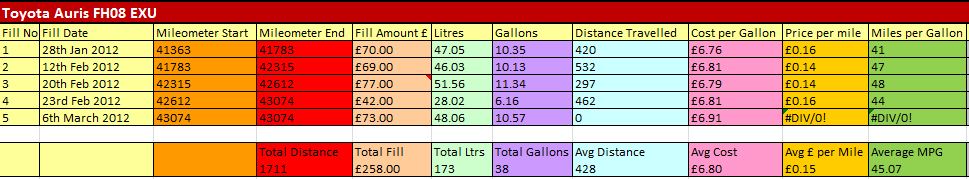

I have also attached a screen shot of the mileage records I keep - currently i'm around 45 mpg for mixed driving on dual carriage ways / country roads and an odd trip down the motorway. I think this is pretty good considering my style of driving. I've got a big trip from the Midlands to the South Coast at the end of the month so it will be interesting what I get on that journey.
