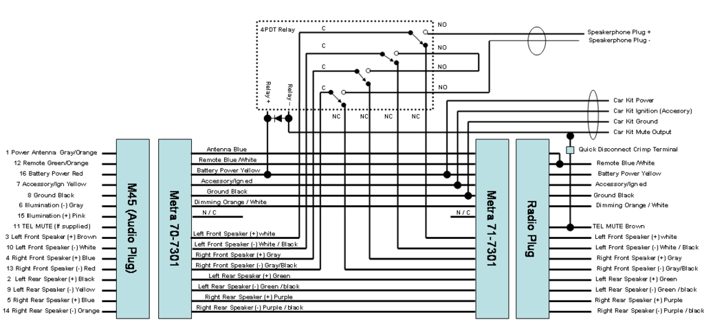

Hi,
I have a handsfree that I would like to wire into my 2006 Corolla hatchback e10. What I want to know is will I create any problems with the car when wiring it up. The cable costs 35 euro which is a bit out of my reach so I am making my own relay cable setup and plan to cut some wires behind the radio to do this job. I plan on following the set up in the attached picture. Does my car have a canbus system and will it be affected by this job. I plan on disconnecting the Battery before 30 mins before I start the job. Also might get one of the toyota clocks that goes in the center of the dash too if i can find it at the right price. Just to note, I still have the factory cd player in my car.
Thanks to everyone for ye're help.
