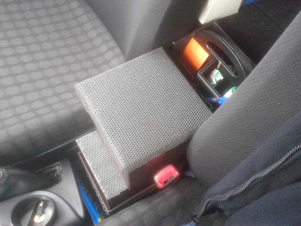

wilkinson stores do a nice line in faux leather boxes , they fit a treat and stack up to make a good arm rest /storage box. 2 narrow ones on the bottom brings you up to around seat level , then a square one on the top for the arm rest, i've put an anti slip mat on top of mine.
i'd attach a photo but i've got the rav today
Drop a photo on when you get a chance :-)
here's the photo . non slip mat at the bottom , then a box , next box upside down, double sided tape to attach lid to bottom box,chamfer the rear end of the box to fit between the seat handles, velcro / double sided tape or non slip mat on top of that to attach last box. covering to suit you needs , and away you go.
i never move the passenger seat as i dont use the rears, but when i do it's just a matter of lifting top 2 boxes out to move seat. got the boxes in their sale so about 12 quid covers the lot. i've now got more storage than i need. stuff i need but only use occasionally in the bottom, next one is where the mp3 player lives, top one has spare/sun glasses pens

Neat bit of work there Tony. I can see the attraction of having the various storage compartments, bottom for things rarely used, like say, demister wipes in a bag, Spice Girls CD's, top one for your marmite sandwiches and Worthers Originals...
:g::goof: :lol2:
Looks very nice Tony! Possibly a improvement over mine... I need to re cover mine actually :)
