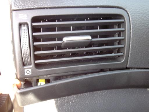

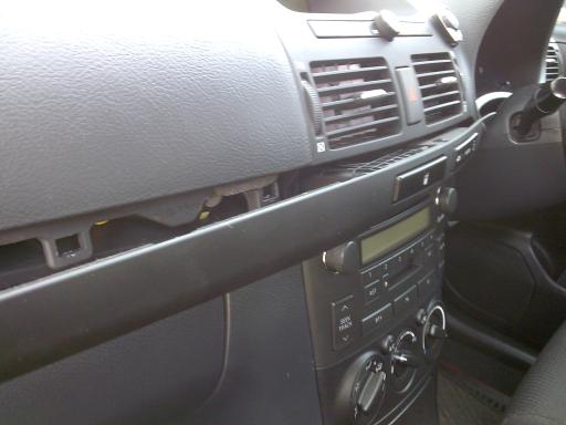

If yours is a T25 then the strip of dash which houses the cup holder and demist button pulls off. Start at the passenger side and work towards the centre, easing it straight back. It's held in by a few push clips.
Here we go- In pictures. Hope this helps.
