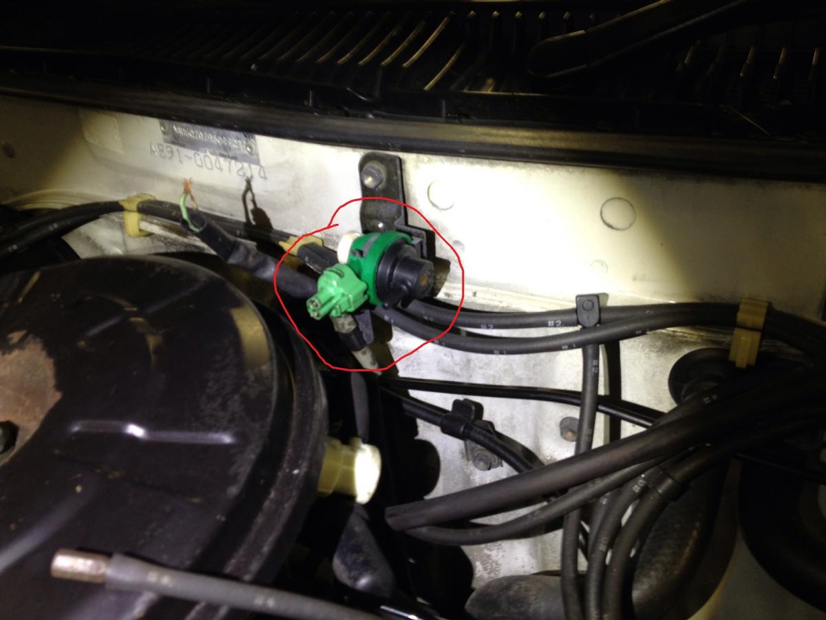

Hi, I recently bought a 1988 corolla fx-g and it is not idling very well, when i had a look under the bonnet i found this with the wires cut and the air hose plugged with a screwdriver bit.
Can someone please tell me what this is so i can do some further research into it?
Thanks for any help in advance.
post-126520-0-72629000-1350798480_thumb.
Hi,
Believe thats the MAP sensor.
Sometime it and its pipline to it gets filled with engine Oil sludge so important you check the pipeline is clear before fitting a new sensor.
Dont think it's a MAP sensor - not on a 1998 engine IIRC.
It looks like more like a VSV ( vacuum switching valve ).
Where does the other end of the blanked off vacuum pipe go to - charcoal canister ??
