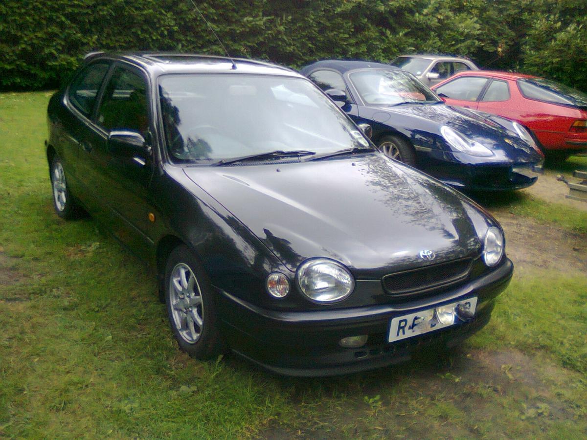

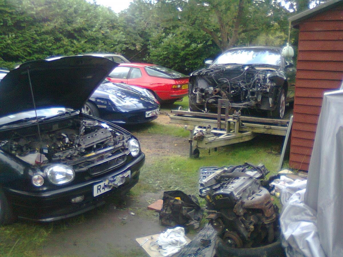

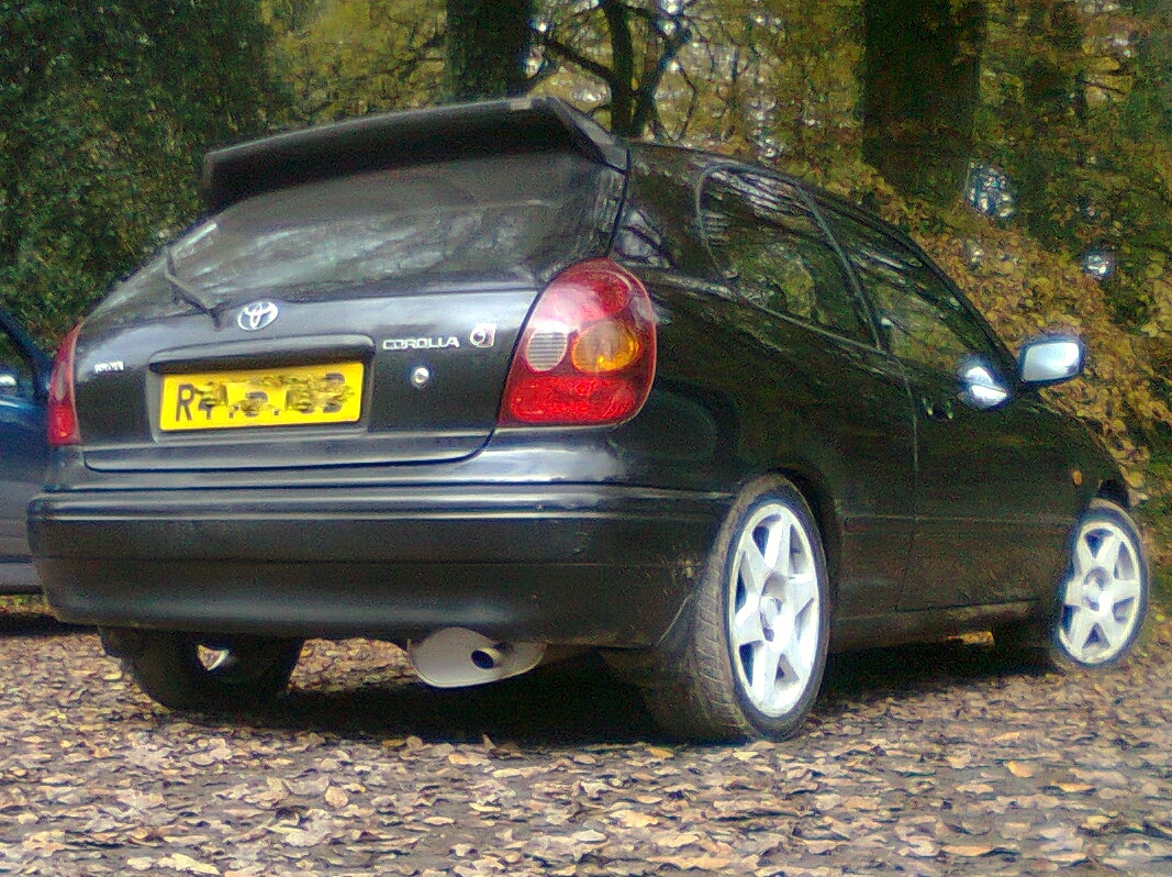

I joined the forum a few months back, at the time buying a friends G6 after he had spun one of the big end bearings. Needless to say after a lot of blood sweat and beers she's now back in full form, replacment engine 4efe (for the time being ;) ) all the usual suspects; cam belt, water pump, Oil pump, clutch, brakes all round, new fluids etc etc, with not much avoiding a thorough clean and overhaul. threw in some larger injectors and manifold and she is now returned to her former glory... if not improved with the edition of genuine TTE rear spoiler, and a set of TTE Mim 16's to set off the look. shortly to be followed by genuine TTE front bumper, and a set of Tein super strut coilovers to tighten thing's up a little!
not the most photogenic of picture's i must add, but thought it aptly time to at least put one or two odd ones up :)
big plans, for the old girl... watch this space :)
